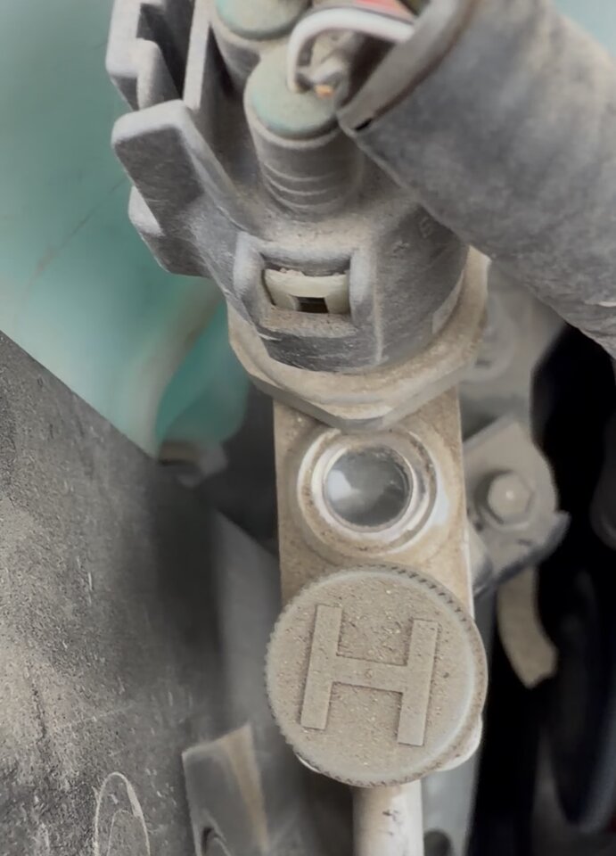

    Has anyone actually verified there is no refrigerant leak? A big leak would have similar cooling when recharged and no cooling soon after. You should observe the sight glass next to the H access point when it is trying to cool as an easy no tool check. Solid column of liquid flowing is good, foamy bubbles is low refrigerant, no fluid movement is compressor failed or no refrigerant.
    Its best to see the sight glass when full and good ac to compare. This was 5 oz low.

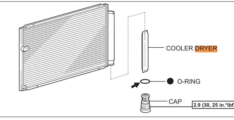

    Assuming a compressor grenaded, the condenser is first in line followed by the receiver dryer mounted vertically on the right side of the condenser. Then its the expansion valve under the dash just in front of the evaporator.
    If dryers and expansion valves get clogged a flush does nothing because both have very small openings.
    Expansion valves are always changed after destructive compressor failure. Often condensers are also changed.

    Also check sight glass as discussed above when working.
