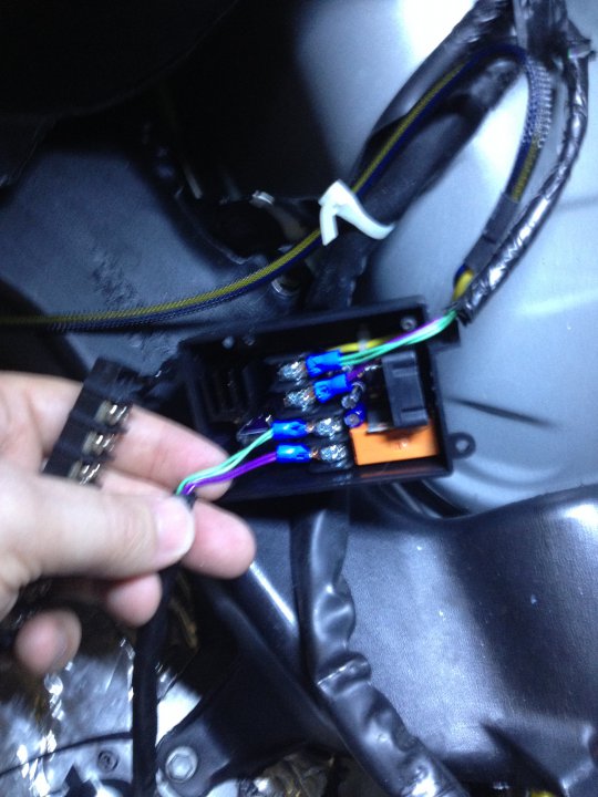

    The grid charger box sits on a shelf in my garage when not in use. I actually purchased the Amphenol plug to cover the end of the connector to keep it safe. I didn't realize my spare tire area was filling with water. The plug got into that slightly and got wet awhile back and threw the ground DTC, don't remember what the actually code number is. So I moved and fixed that, it is up and safe now.
    The below picture is off the patent pending controller for the grid charger. I removed the purple/purple, green/green wires and connected them directly to a terminal strip. You can see it in my left hand. Anyway this didn't help and the problem is actually worse now?
    I completely removed the cooling fan assembly to clean it and check it out better etc... etc... I even tested it with a 9 volt and it runs but now after reconnecting the motor and taking the grid charger control out of the system the motor doesn't run at all. On TechStream it shows 0.0 Volts and soon generates the DTC's I mentioned within a few seconds of beginning the test? Even at Full Speed of 6.
    The resistance across the motor is 1.1 ohms which seems ok to me. Not an EE so not 100% sure but the motor seems ok. So now I am not sure what to test next? Might end up having to put it all back together and go to Toyota anyway it seems.
