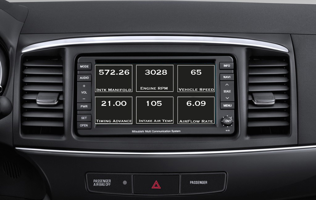

  6. bobzchemist
    bobzchemist Active Member
    Aug 2, 2016
    507
    342
    Kennesaw, Georgia, USA
    Also, there's this:

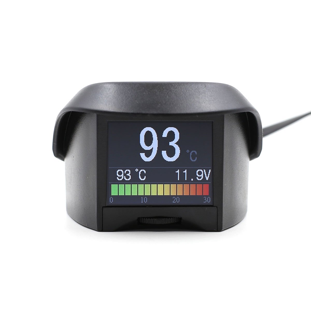

  7. bobzchemist
    Aug 2, 2016
    507
    342
