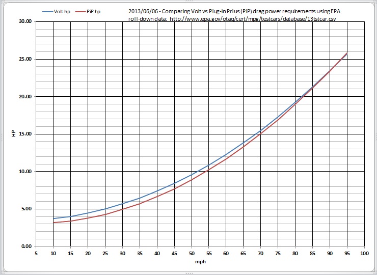

    Linear formats make a head-to-head comparison difficult so I looked at vehicle efficiency:
    Column 1
    0 [th]Volt Est.[th]PiP Actual[th]metric
    1 [tr][td2]36 kWhr/100 mi[td2]27 kWhr/100 mi[td]electric efficiency
    2 [tr][td2]36 MPG[td2]50.5 MPG[td]ICE/hybrid efficiency
    Source: john1701a and drinnovation
    This was a surprise to me so I went to the EPA roll-down data:
    Column 1
    0 [th]Volt[th]PiP[th]metric
    1 [tr][td2]26.402[td2]23.39[td]rolling drag
    2 [tr][td2]-0.022[td2]-0.163[td]drive train drag
    3 [tr][td2]0.019[td2]0.021[td]aero drag
    Source: http://www.epa.gov/otaq/cert/mpg/testcars/database/13tstcar.csv
    The PiP has significant lower rolling and drive train drag. The Volt has a little lower aerodynamic drag but very small. In effect, the larger PiP has significantly lower operating drag power requirements below 85-90 mph. I'll post a graph later.
    Sources:
    PHP:
    18,477 Total Miles
    ,328 EV Miles (displayed amount)
    12,123 HV Miles (displayed amount)
    365 Days (12 months)
    574 Recharges (based on capacity replenished)
    239.9 Total Gallons (measured at the pump)
    1,721 Total kWh (including charging losses)
    1,505 Total kWh (displayed amount)
    77.0 Lifetime MPG
      50.5 MPG
    (HV)
    27 kWh /100 miles
    PHP:
    VOLT APPROXIMATION
    18
    ,477 Total Miles
    ,742 EV Miles (Estimated amount)
    3,735 HV Miles (Estimated amount)
    100.9 Total Gallons (Estimated using 37MPG)
    5300 kWh Total kWh (including charging losses using EPA estimate)
    183 Lifetime MPG
    37 MPG
    (EPA)
    36 kWh /100 miles (EPA)

    Will be interesting to see the graph and I've not see that comparison. (Though drag is only one part of the equation since power train efficiency is also important. )
    Note, that john's 27kWh electric efficiency is only on the low-speed part (i.e. no gas) usage
    while EPA for the volt is for the full EPA test. My personal electric efficiency in a Volt is much better than EPA,
    with an average over the Mar 12-March 13 time frame of 27.519 kWh/100mi. (I do 40-50% better in the summer but only 0-30% better in winter). So actual usage of a Volt can be much better than EPA.
