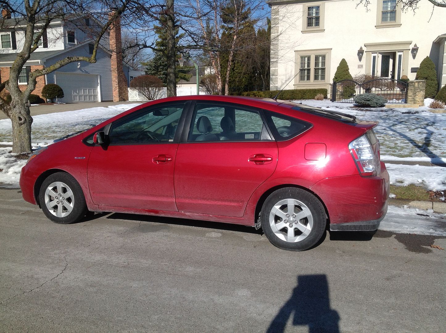

    I am new to the forum and I just acquired a 2008 Prius pkg 6 with 255,000 miles. It is a one owner car that was driven primarily highway miles between Columbus and Dayton in Oh. The previous owner was meticulous on maintenance and the cars runs and drives great. It has a maintenance light on and I notice a valve/engine noise particularly when cold on acceleration. My question is this a good car to have my 17 daughter drive without exorbitant maintenance and repair costs? Are the battery packs expensive to replace, I'm not sure if they've been replaced yet? I also noticed a white looking spot under the car after driving. Is a Toyota dealership the best place to take for service/repairs? Your help/input would be appreciated.
