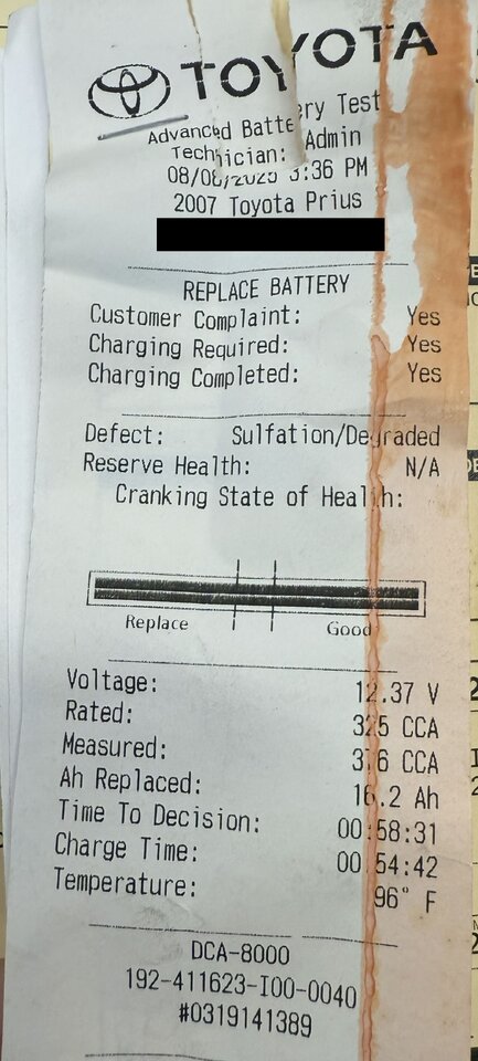

    User Danica posted this dealer's test of her 12V battery apparently done on a DCA-8000 tester.
    At 96F 12.37V is below 50% SOC. If I'm reading this right they pushed 16.2 Ah into it (Ah Replaced) in 54 minutes (Charge Time), which works out to 18A or 0.4C exactly. The thing is, these batteries aren't supposed to be charged over 4.2 A, it says so right on the battery.
    In any case, assuming my math and interpretation of these fields isn't off, how come the dealer can push 18A into one of these batteries but nobody else is supposed to use even 1/4 that much current?

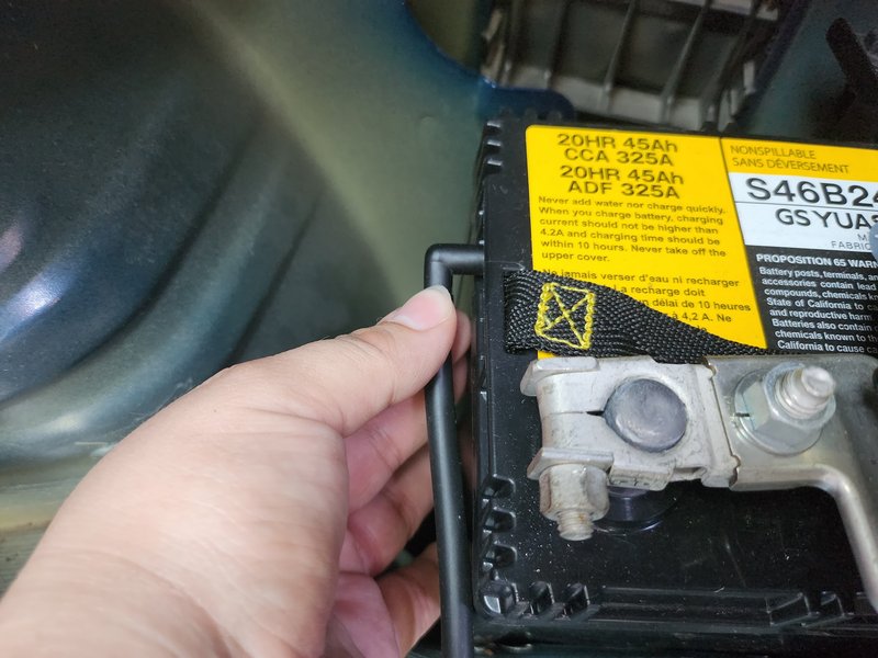

  2. PriusCamper
    PriusCamper Senior Member
    Mar 3, 2012
    13,257
    5,357
    Pacific Northwest, USA
    How much did they charge you?
    The amount of output a battery can handle isn't much different the amount of input it can hanlde, at least in short bursts.
    Can you post a photo of where it says not to charge over 4.2A ?
    Because most chargers at an auto shop that are on wheeled carts can pump out more than 120amps when needed and my 10amp and 20amp smart chargers have sensors to only pump out what the battery can handle and during much of the charging it's pumping max amps.
  3. Tombukt2
    Tombukt2 Senior Member
    Nov 29, 2020
    13,675
    2,478
    Durham NC
    It also states that the battery plates are sulfated or there's a sulfation issue I didn't think that went on in AGM ?
  4. pasadena_commut
    pasadena_commut Senior Member
    May 2, 2019
    2,953
    896
    Southern California
    It wasn't me, this was user Danica who posted it in another thread. The DCA-8500's manual is here:
    https://www.midtronics.com/wp-content/uploads/2019/10/167-000837EN-A-DCA-8000-Charger-Instruction-Manual-Midtronics-SM.pdf
    but it never defines "Ah replaced", just shows it on the example outputs.
    Here is a link to the sticker on a Yuasa battery (same battery I believe):
    https://guide-images.cdn.ifixit.com/igi/ddrWoS4xb64aIPjR.large
    and here is the same battery but branded as TrueStart
    It says:
    That limit is peculiar since AGM batteries are normally fine charging at higher rate than a flooded battery, as long as the charging voltage is kept within specs.
  5. pasadena_commut
    May 2, 2019
    2,953
    896
    Southern California
    AGM sulfates too, supposedly less of a problem than in flooded. The flooded battery method of boiling to remove those crystals won't work on an AGM battery though.

  7. pasadena_commut
    May 2, 2019
    2,953
    896
    Southern California
    It can be run with manual settings (page 35 of manual) to restrict current. Whether any shops actually do that though is another matter.
