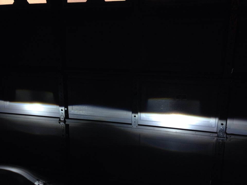

    Put a yard stick in the photo so we can see how many inches off the ground the light is.

    You need to be about 20 to 30 feet away from a wall. Looks like you are right up against the inside of a garage door.

    That's right I'll take a picture with 30 ft away

    Ground needs to be level too. No upward or downward slopes. ;)
