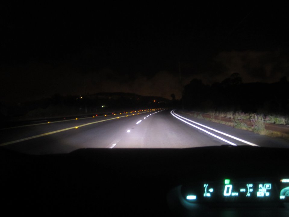

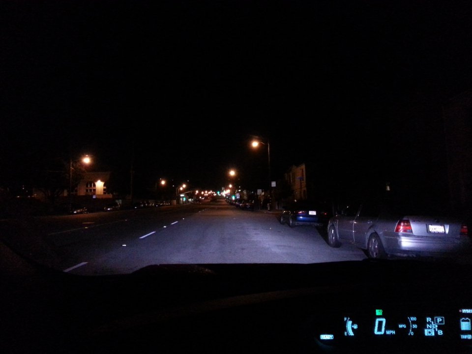

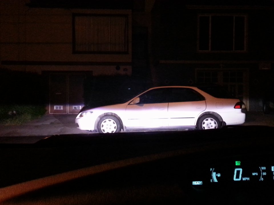

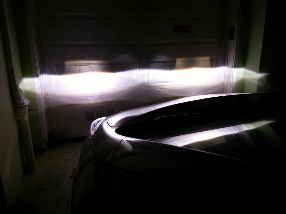

    Here is my few shots from my 35w 6k DDM....using stock relay & wiring, this my 3rd sets on my cars, no problems.
    20130508_015712.jpg Aiming across the street
    20130515_020954.jpg Front of the garage
    20130522_015049.jpg Driving local in SF
    IMG_6072.JPG Driving on Bayshore blvd

    Thanks for the pic... They look good to me. I'll update once I install mine
    Thanks everyone
