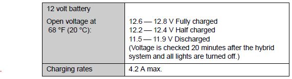

    Thanks for backing me up .. I tend to remebmer stuff like that... this was 2010
    My current 2012 has the same table but says 5 A max ... fo figure !!!
    thanks
  3. Mendel Leisk
    61,373
    42,231
    ^ And maybe the same battery?
    Maybe due to more testing?
    FWIW, contrary to Toyota's instruction, I don't bother to remove the battery from the car when charging. I'd speculate that's the norm for most DIY charging.

    Which is somewhat different than the maximum capacity of the charger being used.
    IF.....you have a charger rated at 6 amps and you connect it to a battery and it ACTUALLY DRAWS 6 AMPS for more than a few seconds, then your battery is beyond dead and needs to be replaced no matter what happens next.
    Typically the maximum charging rate on a reasonably discharged battery is about 2/3 of what the charger is rated at.
    Thus my recommendation of a 6 amp charger maximum which should produce an actual charging rate of about 4......and even that won't last long if the battery is actually healthy.
