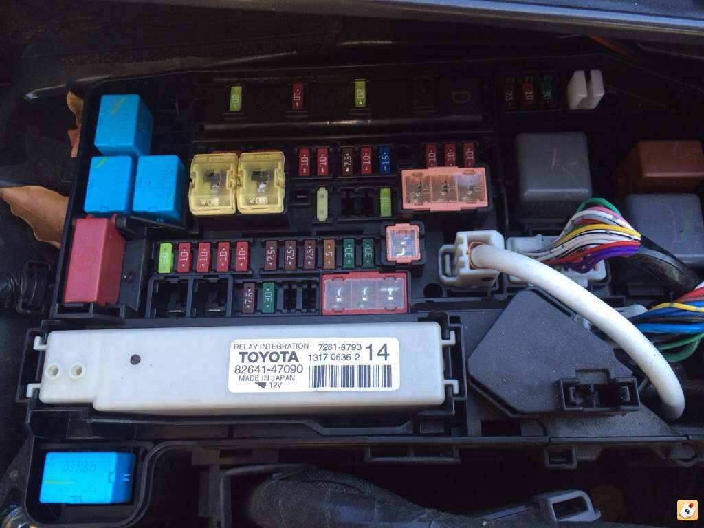

    Just wanted to see if anybody had the same problem.
    My significant other bought her brand new Prius 4 2011. Never really had major problems and always completed recommended oil changes and maitanence including last 50k about a month ago.
    This morning we went to open the car and it was... Unresponsive. Opened door with physical key. Set inside, pushed the pedal and pressed the button. Silence, break is unusually stiff and the only light on a dashboard - check engine. Pressed the button again and one little beep with flashing exclamation sight on the left of dashboard. Pressed it one more time and silence. Inside auto locks and windows do not respond.
    I doubt it's a battery - could it be?
    Also attached are the fuses - do they look normal for Prius iV? I mean is it normal for some of them be missing?
    Any advice is appreciated, before we take it to Toyota.

    Looks like a dead 12v battery to me.

    Sounds like a dead battery. Kind of early for it to just die, a light was probably left on.
    I don't have a Gen3 to compare to, but I would say that the missing fuses are fine. They're probably for an option your car doesn't have or just extra spots Toyota left for future options in later models.

    Thanks!! It was my interior light. Aaa is on its way.

    You can jump it using that Red clip there and a ground. You don't need to open the rear trunk where the battery is at to jump start the Prius.
    If you look at mark's image, you can see there's that red tab, you lift that red tab and its the positive terminal for the battery, you can hook the red on your jumper cable to there and the black to any solid ground on your Prius, usually the engine mount bolt or some hard ground and you can jump the Prius that way.
