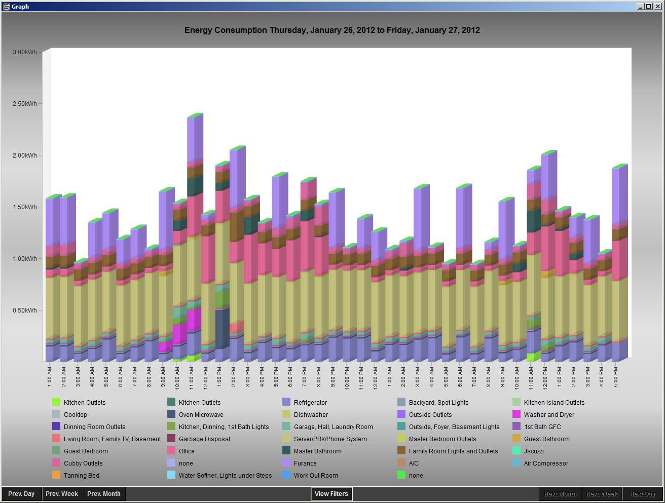

  5. Judgeless
    Judgeless Senior Member
    Jun 30, 2009
    1,821
    257
    Cleveland, OH
    My house uses about 2KWh average if I am not using the washer, drier, oven, cooktop, microwave or air compressor. The AC unit and furnace alone draws 3KWh. Remember a hair drier alone is 1,500KWh.

    You are confusing your units. A hair dryer might be 1500 Watts, but it is NOT 1500 kWh. That would be running a hair dryer for 1000 hours. My house only uses 2kWh in a day when I get power from the electric company, in an emergency I can deal with some 'hardship', such as not using a hair dryer. I have some really cool technology called a towel.

    I made a mistake. It should have posted 1.5KWh or 1,500Wh
    Do you think someone that has their house wired to monitor power at every breaker does not understands how it all works?
    A 60 Watt bult consumes 60 Watts
    Your electric company bills you by the KWh. I pay 5.85 cents for 1KWh
    60 Watts is .060KWh
    5.85 cents * .060KWh = .3348 cents an hour to run a 60 watt bulb in my house.
