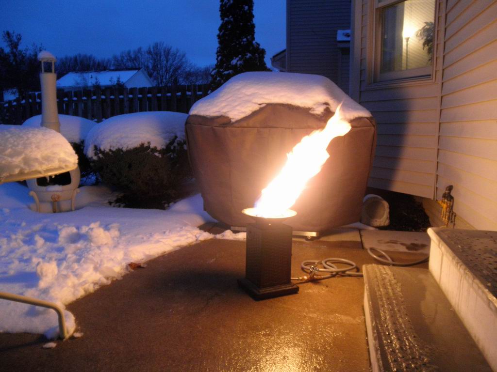

    Talking about things you like to fire up. I just built this yesterday.
    I bought a 10KW tri-fuel generator after the power outage from Sandy. I ran a gas line to the side of the house to power it. When I was running the line I decided to run a line for the gas grill. Then I thought it would be nice to convert my little fire pit to natural gas. I finished that yesterday.
    Next I am going to build natural gas Tiki torches using these.
