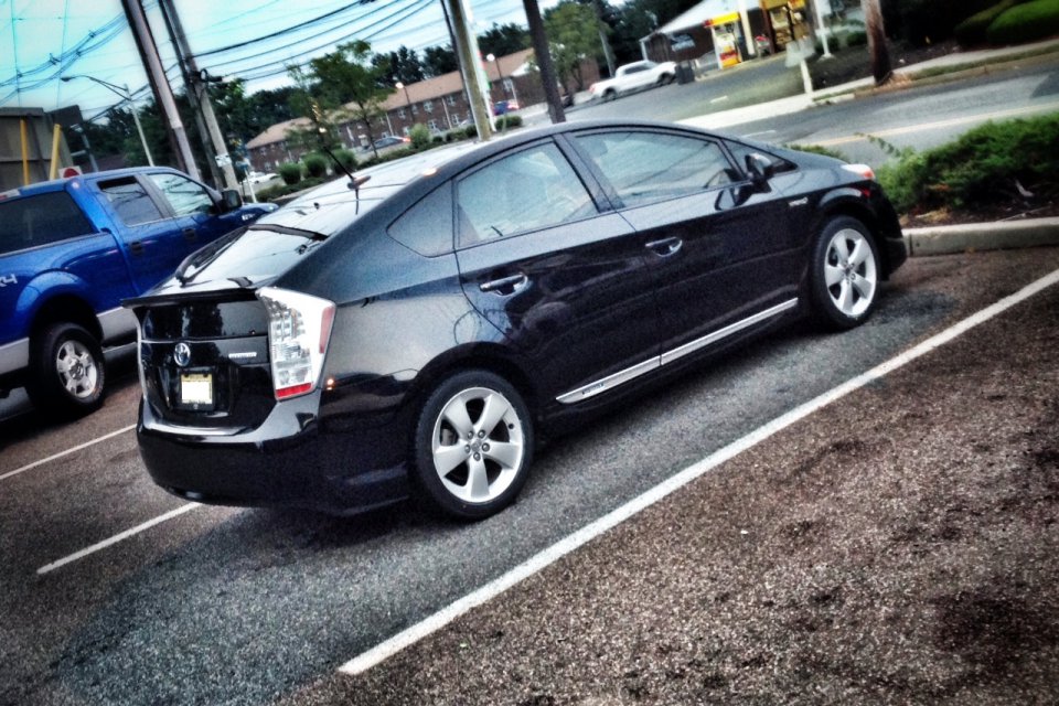

    Got them installed today, loving them so far. Keeping the 15s w/TPMS as spares. Looks and handles great. Thanks for the advice photo.jpg

    Congrats! Looks great!

    Look very good! On a dark car the wheel gap doesn't show as much. With the door garnish looks very stylish! Glad people were able to help you through the BS. Don't forget to rep (like).
