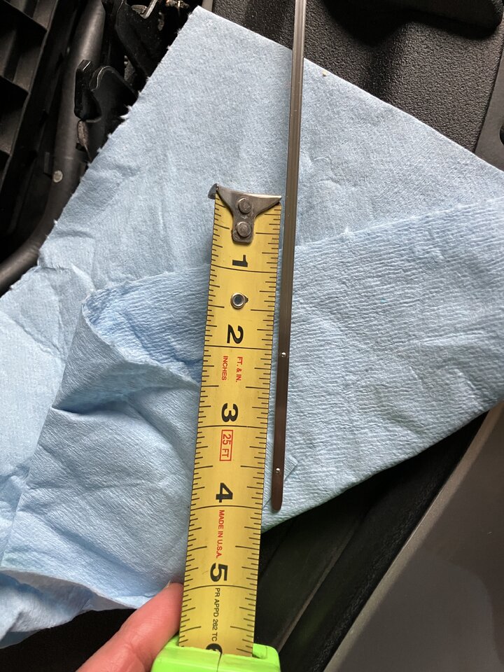

  12. Humble Bear
    Humble Bear Member
    Nov 23, 2023
    131
    49
    Arcadia, CA
    2024 Prius
    1) I normally change my own oil, but I am surprised that a lot of you don't know Toyota gives 2 free services in first 2 years which includes oil change @ 10K & 20K.
    2) @AzusaPrius, the owner's manual says check the oil when the car is in operating temperature but let car sit for 5 minutes so the oil will flow to the bottom.
    3) Owner's manual says from min to max mark on the dipstick is 1.5q and it's about an inch, so 1/2 inch is about .75q that's about 20% of the oil capacity which is way too much.
    4) I had my wife take it to the dealer and have them remove the excess oil and now it's 90% between the min & max which is great. Next service, I will tell the dealer not to overfill and I will check the level afterwards to make sure they do their job right!

  14. Mendel Leisk
    61,513
    42,324
    You're adding to it, lol. I've never seen more than an 1/8'th inch variation, regardless of time/temp.
    Between the full and low pips? My gen 3 at least, it's just shy of 1.5":
    Could be different with gen 5.
    #34 Mendel Leisk, Oct 22, 2025

  19. Mendel Leisk
    61,513
    42,324
    Ok, fresh on the heels of an oil change, I concur.
    When I change mine, I put in the specd amount, with a graduated pitcher, and ignore it for a few days.
