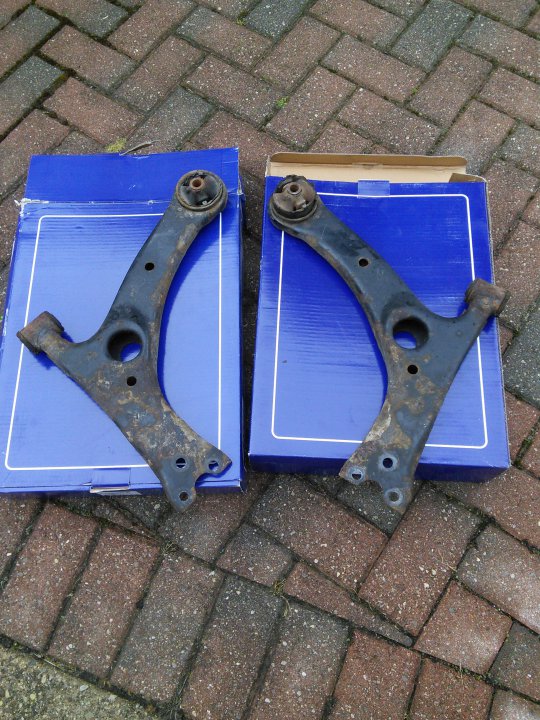

    OK, here's the story's conclusion. I just got my car back from a shop down the street, 5 minute walk. They worked a half day today on Christmas Eve. They would not use my parts because of insurance reasons so I paid $150 per control arm. Still better than $264 each at Toyota. It came to $664 including alignment. The car drives better. I must have been slow boiled because I didn't realize it was driving bad.
    Here are the control arms. The guy at the shop said the salt and calcium attack the rubber. I suppose that's the cost of living in Buffalo.
    I feel that I got a fair deal not that the dealer was trying to do me, its just how they roll. If you're in the Buffalo area I recommend Bailey Tire. I've been getting my tires here for awhile.
    Thanks everyone for the help.
