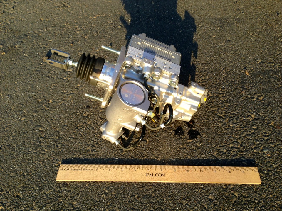

    I agree with you, having worked on brakes on a variety of cars over the past 30 years, but the Prius master cylinder is not the same as other cars. It apparently integrates the ABS and regenerative braking command functions along with the normal hydraulic brake function, plus a power brake assist function not relying upon vacuum as in most cars. If you had to replace all those components simultaneously, the bill would probably run into the thousands of dollars on a lot of cars.
    Toyota tried to cram too much into a single unit and didn't engineer it for a multi-hundred-thousand mile lifetime. One would think that after selling these cars for ten years, the brake master cylinder design would be absolutely bulletproof.
    The Prius brake master cylinder replacement and the subsequent brake bleeding require a laptop with Toyota software to complete plus Toyota service instructions. It isn't something that a backyard mechanic (lacking these resources) should attempt as far as I know.

  7. Former Member 68813
    Oct 3, 2010
    3,524
    983
    US
    As much as I would like to believe you, does it look like a typical master cylinder?

  15. HeinzCatSoup
    HeinzCatSoup Junior Member
    May 9, 2013
    Southern California
    thank you everyone. I'm still trying to contact as many people as I can and will update you for the responses I get. If anyone can get me more contacts, I will talk to anyone and everyone that wants to listen to my story, because I want to make everyone aware how ridiculous this is. However of course I can't sit around and just wait for a response and I don't want to take it into Toyota for a $4k+ repair with uncertainty of getting reimbursed.
    Its true that I am the second owner of the car, and that the original owner could have abused the car (which is what the service manager believes the damage to be "wear and tear"). If the car was abused by the original owner, it sure doesn't show it on paper or in person: When I purchased the car from Toyota of Ventura, the car was in flawless condition inside and out. The original owner purchased some extended care service from toyota and when I check mytoyota website, I can see that the car was meticulously brought in for services every 5000 miles to the dealer, and sometimes even inbetween every 5000 miles, I saw dealer logs such as "tire rotation, oil check, etc" basically everything was done by Toyota of Venture. When I acquired the car, I continued to baby the car. Everytime I used the brakes, I turned it into a game to get as high of an MPG as I can. This means I was always braking gently from far away to make sure the friction brakes dont get used unless I absolutely had to.
    So whats going on right now with my car? I've purchased a used Master Brake Cylinder & Brake Booster Assembly off eBay for $400. I considered installing it myself, but since i'm not 100% sure, I decided i'm going to bring it to a mechanic to install it for me and hopefully atleast get the car up and running since i've been driving a rental car out of my own pocket.

  19. HeinzCatSoup
    May 9, 2013
    Southern California
    A (final) update regarding my car:
    The bad news is.. no help from Toyota. They never got back to me after the 3rd time calling, the dealer is no help either, and I just couldn't wait any longer to get my car fixed and did not want to fix my car there and hope to get a refund/rebate.
    the good news is that the salvaged Master Brake Assembly/Brake Booster I purchased off eBay worked. After replacing the parts, the ABS light continued to stay on. My father did some research online and found that if you short a few pins on the ECU to force the car into diagnostic mode, then step on the brake 8x in 5 seconds, it would reset the brake ECU. presto change'o ABS / Brake light all disappeared and the car was back to normal.
    The first test drive on the freeway was the scary one, because if the brakes lock up again, things could easily go from bad to catastrophic in a second. Today is day 2 I'm driving the car, everything looks good.. so I suppose this story ended well for me and my wallet, no thanks to Toyota.
