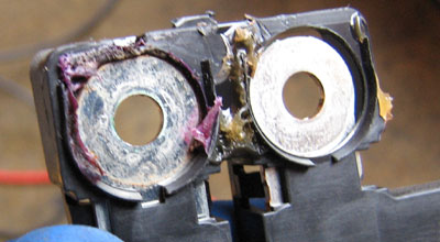

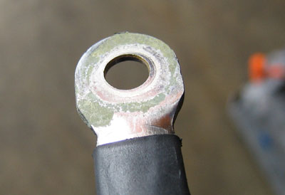

    Here are some pics on the site below with corrosion on the leads. Is that considered a lot?

    Ask if the corrosion can be removed, for example, by sanding with very fine grade sandpaper.

    The three cables that are being recommended are likely from the battery to the negative SMR, battery to positive SMR, and battery to the service plug assembly. These are inside the battery housing, and one end of each are attached to a battery module.
    Electrolyte leakage from a battery module terminal can corroded the cable terminal in a manner similar to corroding the bus bar. The difference is that the electrolyte can creep into the cable where it is crimped to the terminal. It would be very difficult to remove the corrosion and neutralize the alkali electrolyte if it has gotten under the insulation of the cable.
    You might be able to get away with cleaning only the cable terminals, but the residual electrolyte can cause the corrosion to return.

    So, I went there and looked at them. I stupidly did not take pictures. When I looked at them, it did not seem like a lot and asked them to clean as best as possible. Below are pictures from Art's Automotive's website (not from my battery). It was definitely less corrosion than what you see below. It was corroded on the end of the bus bar and the two cables. I guess if Art's Automotive did not replace them I am hoping that they could be cleaned.

    This is what I meant saying "patina" usually can be cleaned with finger. IMHO cleaning is enough.
