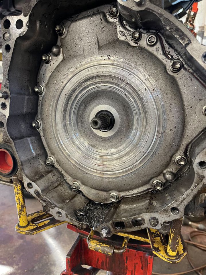

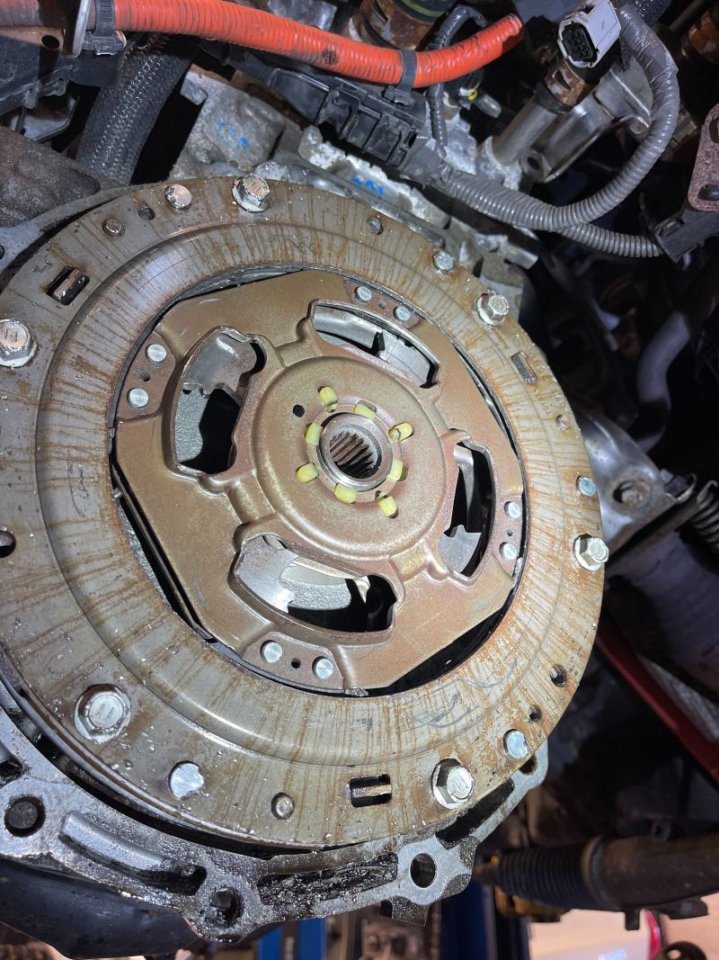

  3. ChapmanF
    27,657
    18,249
    Those look like pictures of a transmission damper whose coil springs have all been pounded to smithereens (lying in the bellhousing in the lower picture).
    Once that has happened, the car will make clatters and rattles just because the damper's got no springs.
    Something else was the original cause of the clatter that pounded the springs.
  4. Nor'easter
    Nor'easter Member
    Nov 16, 2019
    158
    96
    New Hampshire
    I think Aisin used crappy springs that lost their preload over time. And indeed, the rubble you see is the remains of the springs, seasoned with bits of cast aluminum from the transmission housing, lubricated with ATF from where the trans housing wore through. I'm hopeful that the updated part I bought from Japan has better springs.
  5. ChapmanF
    27,657
    18,249
    I would be pretty surprised ... that aspect of how the Prius 'damper' is built is shared with pretty much every manual transmission clutch disc ever, kind of a mature product space.
    I see the mileage was 121k at the start of this thread. One really just doesn't hear of clutch discs turning their springs into rubble over 121k miles for no reason. Could it happen? Well ... never say never.
    By the same token, the Prius powertrain does have the feature that any misfiring for any reason, possibly even just in some earlier period of the car's life, works those springs like crazy.
  6. Nor'easter
    Nor'easter Member
    Nov 16, 2019
    158
    96
    New Hampshire
    The Prius bumps starts it's engine... every single time. That right there is a lot of wear and tear on the torsion damper.
  7. ChapmanF
    27,657
    18,249
    And yet the number of Prii that pass 121,000 miles without having pounded their springs into confetti seems rather large.
    The "bump" comes from MG1, which can be spun with any amount of torque the ECU chooses to apply.

  10. Nor'easter
    Nor'easter Member
    Nov 16, 2019
    158
    96
    New Hampshire
    Car never had any cold start shakes, never set any codes, leak down numbers were 100/98 ish, borescopic inspection was fine, plugs were perfect, the EGR was cleaned out end to end and found to be dirty at 120K (of course) but without obstruction. Consumes neither coolant nor oil (synthetic since new). It's always returned 48 - 60 mpg. The only "roughness" we've experienced with the engine was after the damper had obviously loosened up and was rattling like crazy, but only under certain light load conditions, e.g. climbing a shallow grade at 20 mph. It -always- ran great at full throttle, and it -always- ran smooth at no load.
    I agree that there's no excuse for such a failure. It's literal 100 year old technology. But out in the real world, the first two pros that looked at the car ID'd "failed transmission input damper" immediately, neither suspected misfiring, both had seen this failure before. And the original 2010 part is obsolete, superceded by a later part #. You can find videos on Youtube that show loose and busted dampers. It happens.
    Anyhow, I expect the car to run like a top now. We pick up tomorrow morning.
