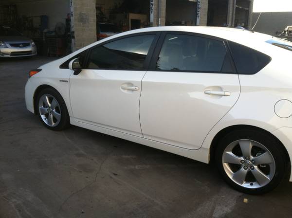

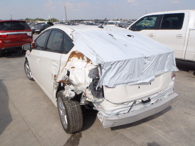

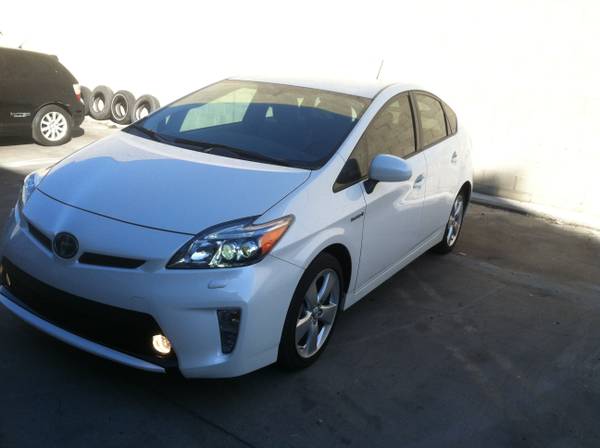

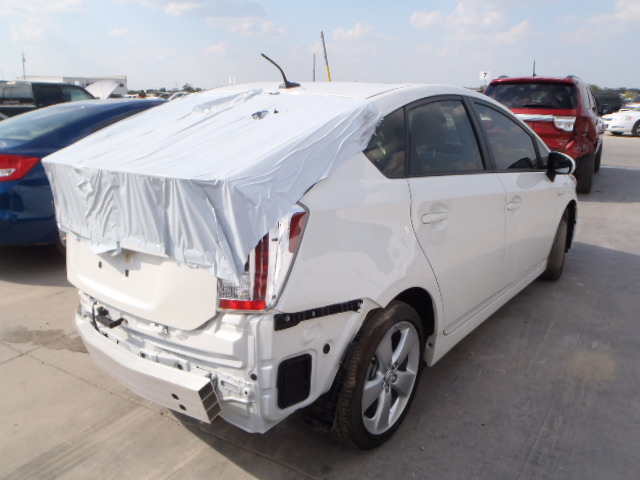

    This is a Prius Five that has a 35,000 sticker price with the technology package. The seller is asking $21000 and it's already all fixed. For a 2013 with 10,000 miles, whatever fire damage is on the car should surely not be 14000 worth of damage? It really has fixed up nicely and you can't even tell by looking at it. I know he had to weld on another rear quarter panel so all those parts around there had to be replaced.
    I've uploaded some pictures of it. The seller advertised it as a Prius IV and not knowing it's a Five with Technology Package. It really is a steal.

    The very fact you're asking for help shows you don't know what you're doing or looking for (no offense). As such you should walk away from that car.
    Why do you think the insurance company didn't want to repair it! The car is going rusty already which unless repaired correctly, will start to rust through in the future.
    If that car was going for $5,000 I'd give it a go, otherwise look elsewhere. (just my opinion of course).

    Yes I'm not familiar with the electrical and mechanical aspects on that cars. I don't really know what's in that area of the burned area. The rusted/burned parts you see is not there anymore, the entire quarter panel was replaced with a donor car quarter panel.

    It looks as though the left rear suffered suspension damage too. You might also be concerned that the traction battery has suffered. This sure looks like a crap shoot unless you have it inspected by a Prius expert who can evaluate the repairs that have been made and the present condition of the car. I think you will find too that there would be no warranty from Toyota for this car.
    For $21,000 you could probably do much better.
    Data Daedalus likes this.
