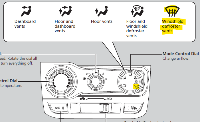

    All our previous cars being Honda, I was a little surprised, to see no windshield-only option. Screen-grab from a 2017 Honda Fit:
    Short of stuffing something in the footwell heating vents... :rolleyes:
    It's been a while since I've used front-defrost, but I seem to recall it does light the A/C button (if it's initially off). Still (as you intimate regarding ScanGauge's AC WATTS?), it definitely is using AC.

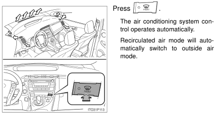

    In any case, the car's going to make that choice for you:
