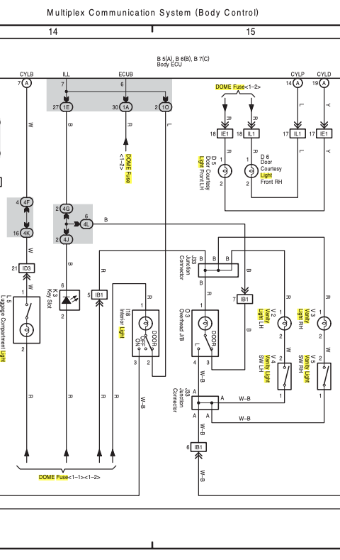

    Also on a side note I just noticed my vanity light isnt working now
    edit: also I did the battery testing after the car has only been sitting for an hour in my parking lot after using it all afternoon

    Coincidence. The bulb has blown. How often do you check this?

    I also find it a coincidence that not only 1 bulb but two vanity light bulb went out and I cant remember the last time I checked it maybe like a couple of weeks ago?

    A bigger coincidence for sure, but if you're not checking them regularly, you have no idea when each blew. You did check that no one switched the switch to OFF unbeknownst to you, and that the shutters are all the way open? You can know the bulbs are okay for sure by checking each bulb for continuity with a multimeter set to Ohms. If both bulbs check out, then check the fuse for that circuit. It appears those are on the DOME circuit from my reading of the electrical wiring diagram, by I could be wrong and am happy for others to correct that.
    [EDIT] Just some further detail on the DOME circuit as it relates to the vanity lights.
    The DOME fuse goes to IB1, then to junction connector J33. Both vanity lights have an individual wire from this connector that separately powers each light. So logically, if both lights went out at the same time and the bulbs check out as good, then it makes sense that there is a bad connector or broken wire that is at J33 or back from it towards the fuse box.
