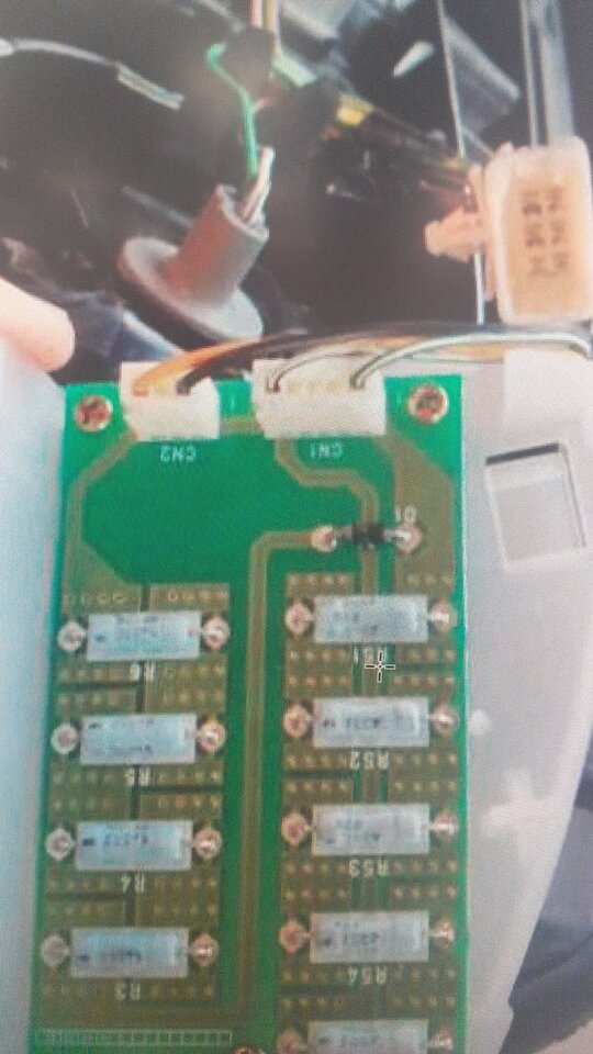

    Hi. I need a new rear light that includes an offside fog light. depo 212-19J8L-UE does but comes with no bulb holders and wiring so you have to transfer your wiring. How do I disconnect the wiring from the LEDs and reattach it to the new light. I think it plugs into a circuit board. Has anyone done this?

    You snap open your rear tail light it all snaps apart the board is on bottom wiring running up really easy to do . I didn't know the depot you had to transfer the LEDs just regular harness that has sockets for the other bulbs . But I don't have that brand and I don't know about the fog light whatever it is you're talking about this EU car?

    Put the thing in an oven for about 30 min 160 degrees or so the lense perls rt off . All the painted chrome pieces snap off get all the wiring circuit board ya need . I don't know how the depot light works whether you leave lense and go thru back possibly .

    Ok the fog light is just an extra bulb at the bottom. So four pictures. Back of depo light, my wiring removed from OEM light and the back of my own light and the circuit board. I haven't removed mine yet actually but those photos are of the same thing. There's two connectors. The larger one is the easy one. The little one must be for the leds. I found a picture of the PCB online. I think it goes in CN1.

    Update - I bought one from a breakers and it works fine. I didn't remove any trim to install it. Was easy enough to remove the two nuts with a small wrench. It's the udpated silver one so I hope it fairs better.
