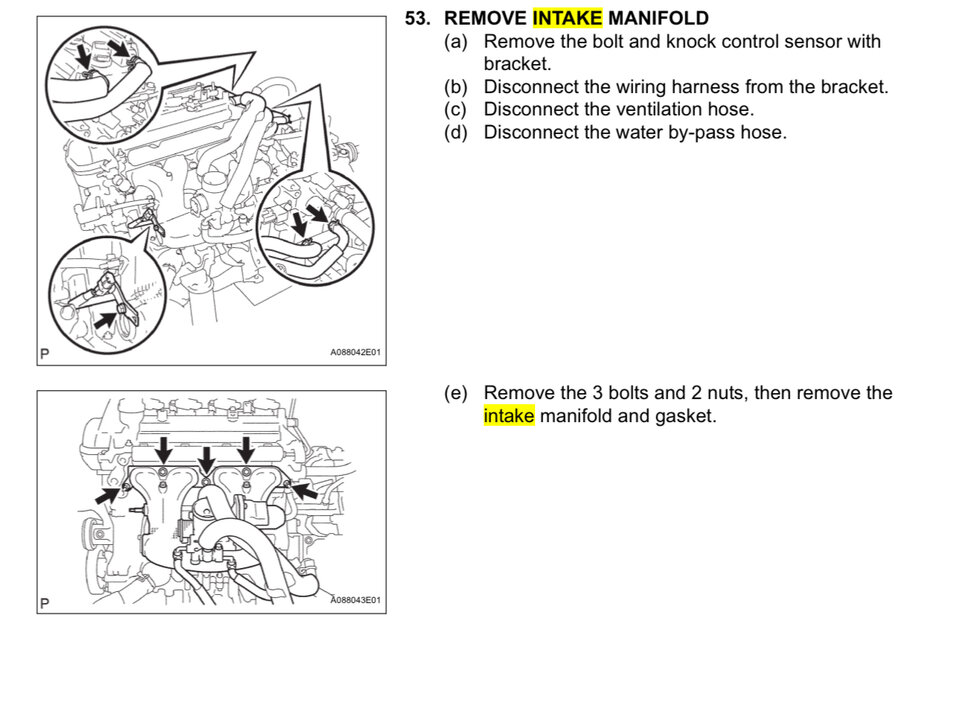

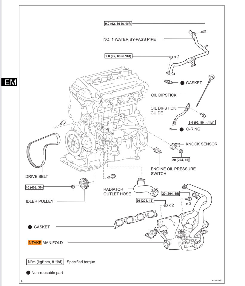

  7. rjparker
    rjparker Tu Humilde Sirviente
    Jun 6, 2008
    11,104
    6,967
    Texas Hill Country

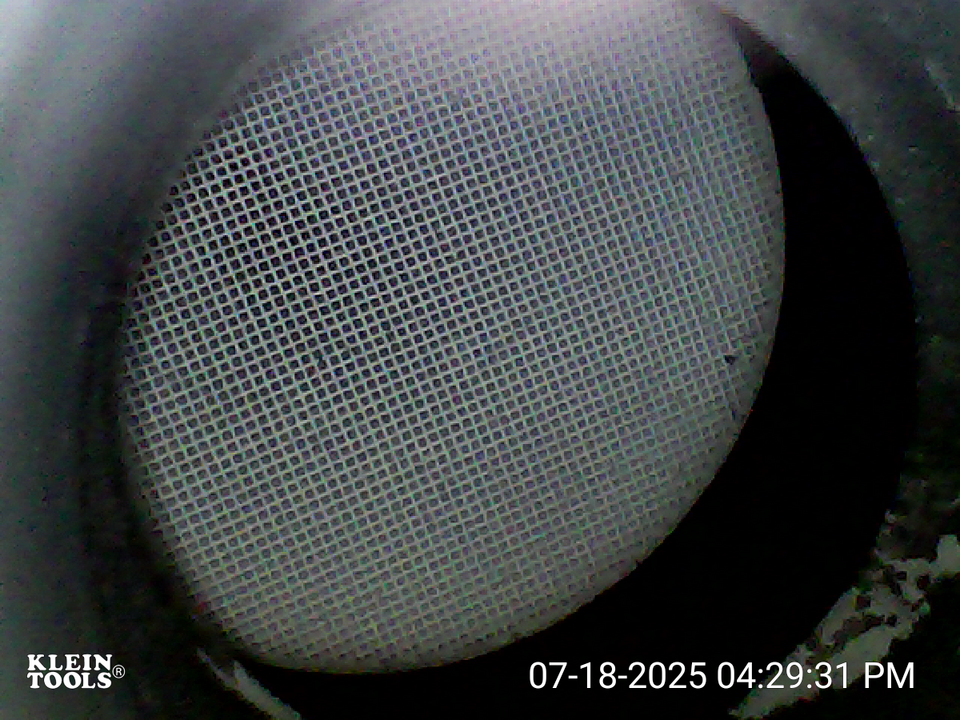

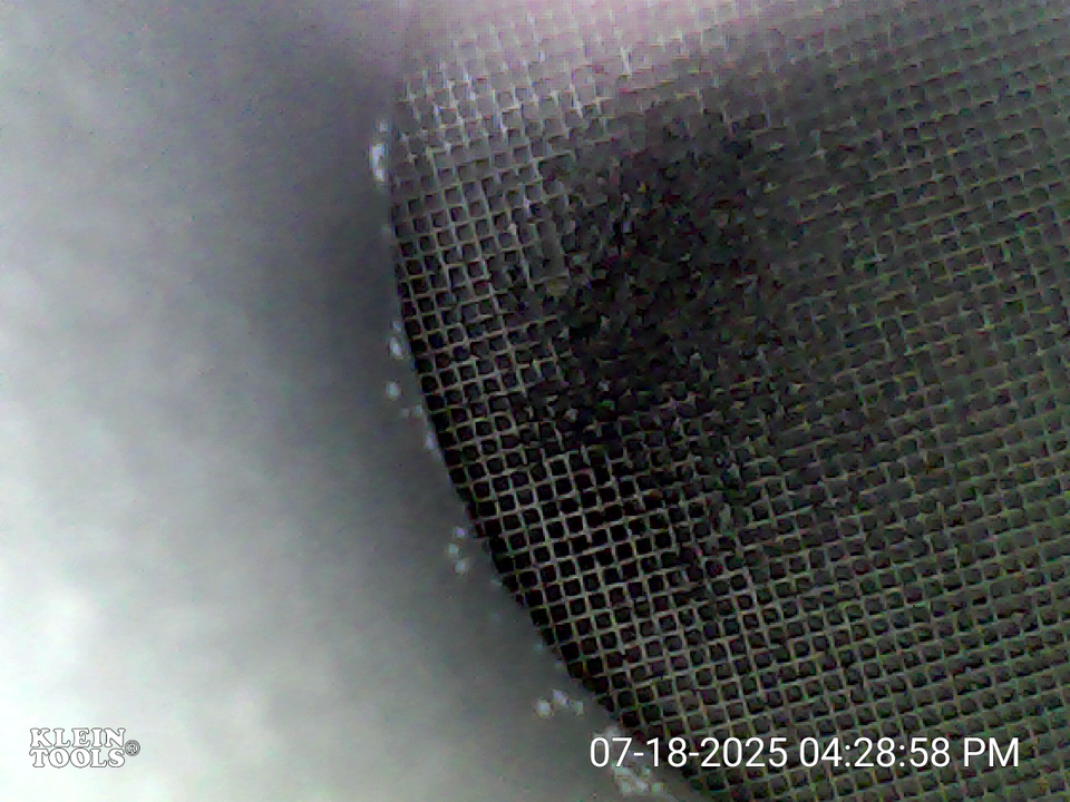

    also, here are the photos I gathered from the 02 sensor. The dirty portion is on the front of the car, the clean is the rear.

    Our gen2 catastrophic inverter was blocked like that, it got to the point it was hard to drive and the exhaust back pressure would cause the engine pipe to push away from the manifold, against the springs, then bang back into place as soon as the pressure released ..... it sounded sort of like a timing chain rattle and sucked me into replacing the timing chain, it did have 680,000kms on it at that stage ..... but the problem got worse.
    When I finally dropped the cat, that whole area had carboned over, a replacement aftermarket cat brought it back to life .... along with a new fuel filter ..... the most likely cause, a lean burn heated up the exhaust sections and the molten carbon was deposited on the partially blocked face of the cat.
    The Australian version has a plastic fuel tank and a fuel filter under the left hand front, about half way along the front door, attached to the inner chassis rail.
    The poor old Gen 2 had a whole new lease of life after that and continued for another 100,000 kms before something strange happened to the drive line .... either a failed CV joint or judders in the drive .... so it became the parts donor for our '06 Gen 2
