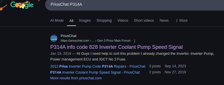

    Perhaps @ChapmanF or @SFO or @Mendel Leisk could help yo go further down the Toyota techstream rabbit hole with this? Seems like you've done everything right so far and that getting more options / expertise in Techstream is what's going to help you figure this out. Or at least that's my impression after taking a look at the links:
