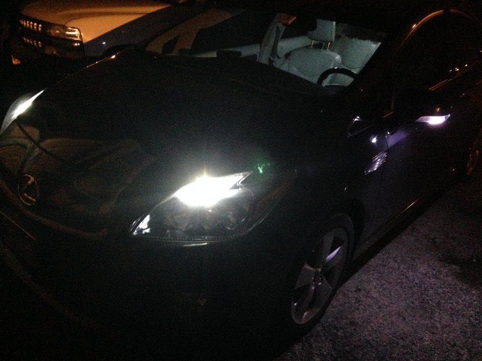

    i bought some 3W leds from ebay from Japan they are super bright. pictures to follow.

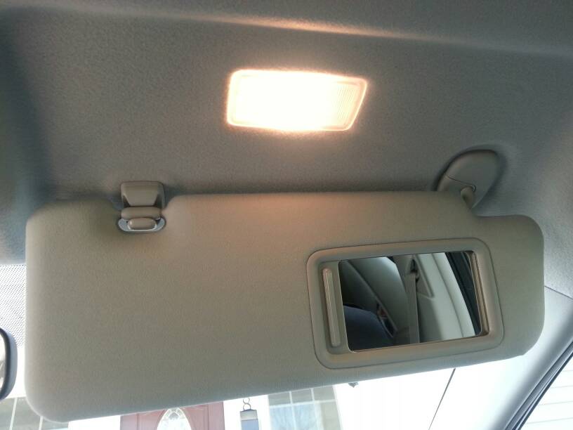

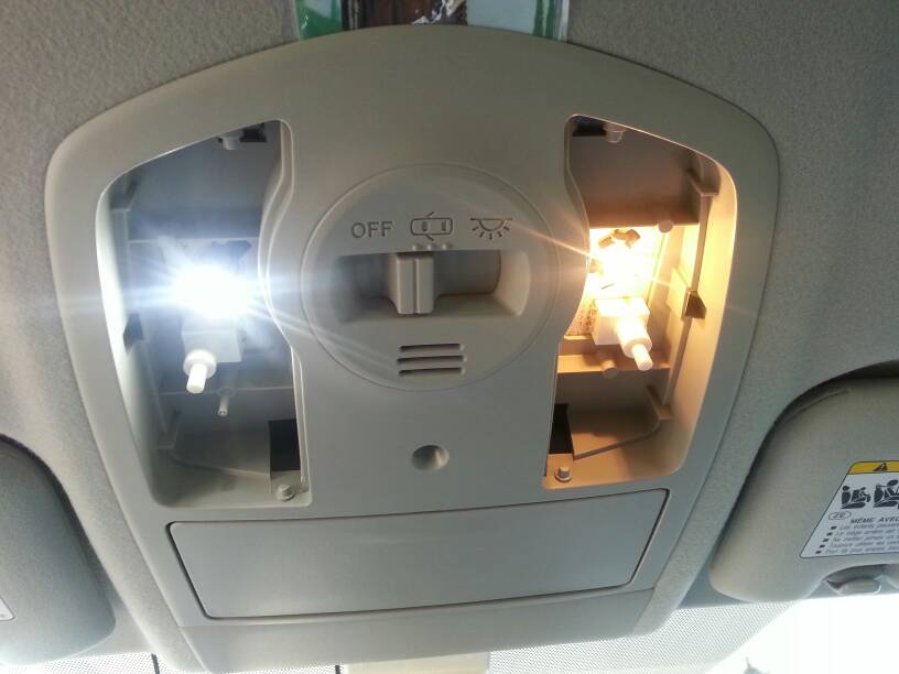

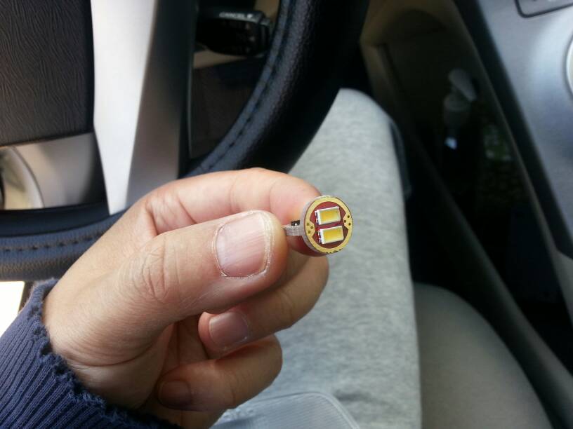

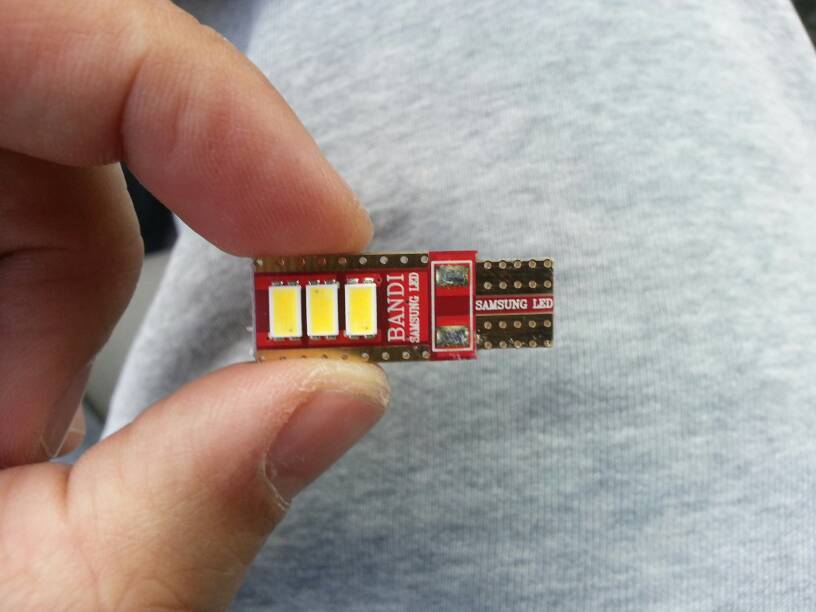

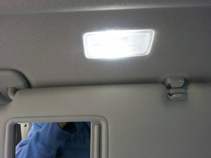

    I bought these from eBay for interior. So far so good. I bought another set to try the shorter ones for parking lights. We'll see if those work out or not. If not, I'll keep them as spares for my interior. I believe they were $27 from S. Korea.

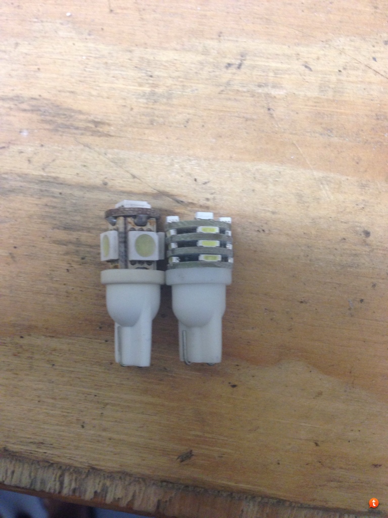

    I just got mine in from IJDMtoy after seeing this post. I wanted something less blue then my old ones to match my HIDs more. They are actually shorter then the LEDs I previously had ill upload a pic in a few no night time shots yet. New ones in the right old is I believe 5smd.

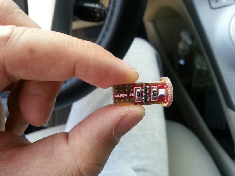

    BTW, here is a pic of the one that burned up for me. I would just avoid any that look like this (ie. flat panel surface mount type):
