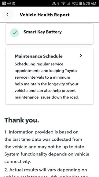

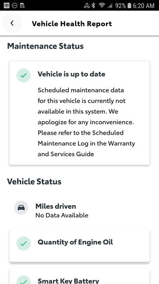

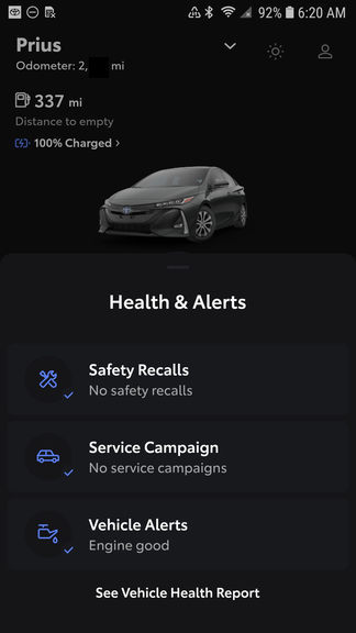

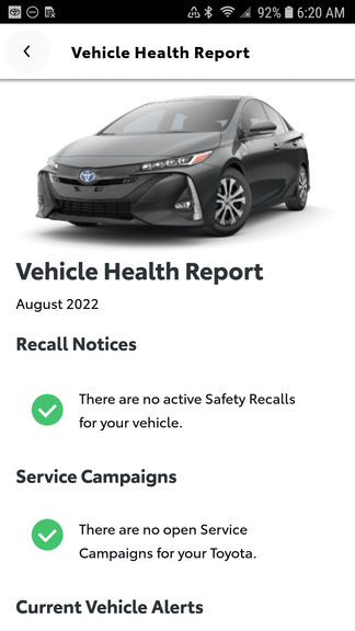

    Here is what I see:
    Notes: Can not change or set schedules.

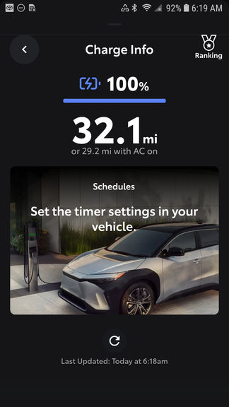

    When charging, charging status is indicated,
    the percentage, and the approximate time left are shown.

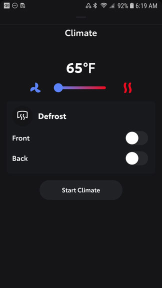

    Notes: Can not change, or set, Temperature or Defrost settings.

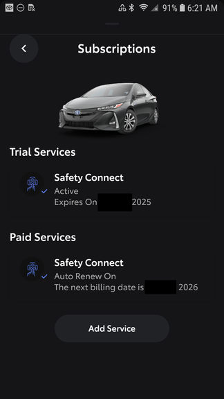

    Notes: I locked in my subscription rate at $80/year.
    Hence, why I have a Paid service shown.
