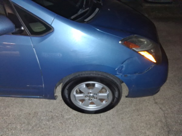

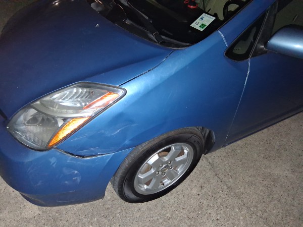

    Im looking for both front fenders and don't wont the badge holes anyway. mine only has the badge holes on the passenger side. I found them for $65 each from AZ, but the shipping. I was going to pull the trigger, bite the bullet and purchase them but whopper $650 bucks with shipping from AZ to new orleans. That made it a no go for me with my bankroll. That's 20ish percent of what I paid for the car.I recently bought a seaside pearl 2g and have been 17580.jpeg 17578.jpeg My YouTube videos are at channel youtube.com/@2Gprius NOT that I have any idea what I'm doing.
