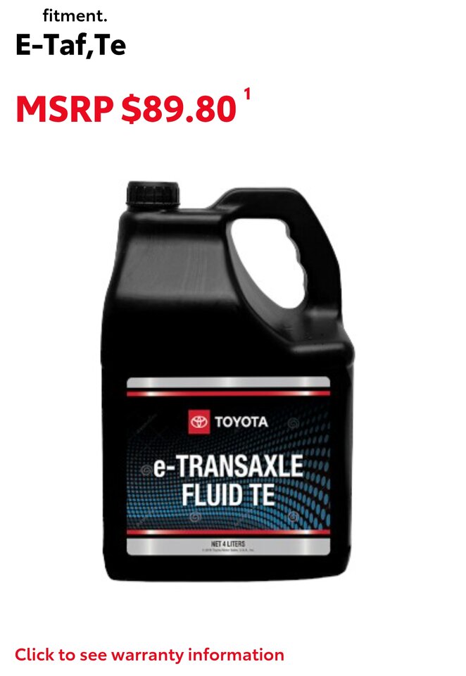

    I would change it to TE. The viscosity is different and they're designed to do different things. The transaxle in the gen5 is not the same one as in the gen4, and it was designed with TE in mind.
    For an AWD, you need two jugs of this: 08886-81986. Unfortunately, you're going to have about 3/4 of a jug leftover as you need 5.1L and it only comes in 4L jugs.
    If you buy in the next 11hrs, you can get two 4L jugs of TE for a total of $105.55.

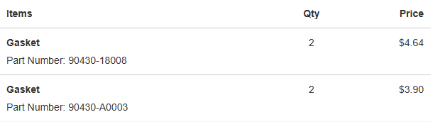

    I also bought gaskets, but I was not sure which gasket I needed. Repair manual does not say, so I bough these 2 just in case. Because Chatgpt is %100 sure it is ---A0003 one, but in the website, it says it might not fit. ---18008 one will fit. I will see.
    Only thing is, I have 1 floor jack and 2 jack stand that came with that. I need to lift the car and make it level. So, it will be difficult. First I need to lift front left and right, then take the floor jack and lift back middle. But I am not sure if that floor jack will fit there. Mine is kinda small.
  13. Hammersmith
    Hammersmith Senior Member
    Jul 26, 2021
    2,449
    2,511
    North Dakota - USA
    2023 Prius
    Limited AWD-e
    90430-18008 appears to be the correct one. You need 2. One for the drain plug and one for the fill plug. Same for the rear transaxle for those that have AWD.

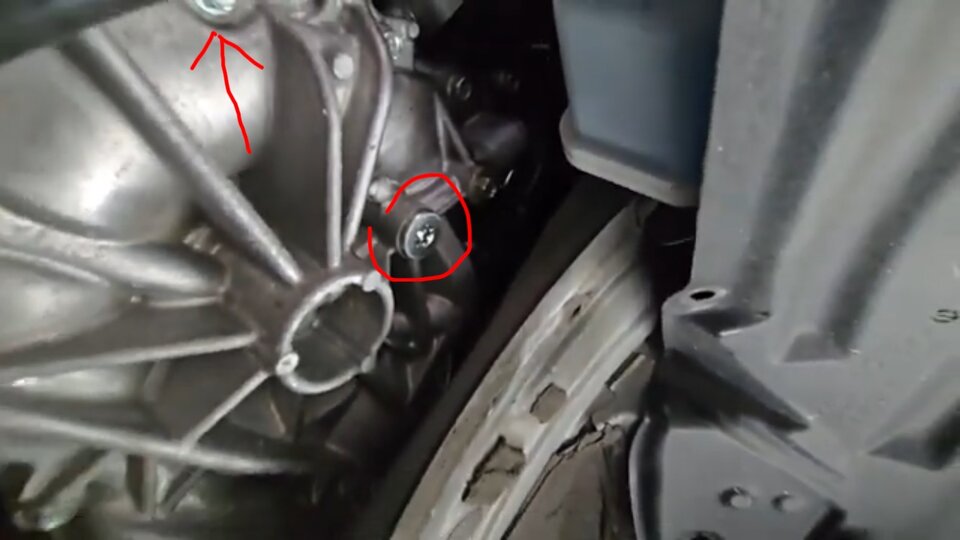

    TODAY I tried to do my own transmission oil change and I failed. First, did I locate the drain and fill bolt correct? See the video, first one is under the transmission and I point it my finger. That one is drain, and second one ın the end of the video is fill bolt, right?
    If yes, I can not remove the fill bolt. I tried but I did not want to damage to the nut.
    if I go Toyota dealer and give my transmission fluid unopened, would they only charge me labor and do it?

  19. Mendel Leisk
    61,401
    42,251
    I’m not familiar with gen 5, that said:
    the first bolt you point to may be coolant drain. In screen grab, circled is a good contender for transaxle fluid fill bolt. The apparent bolt just on edge of frame, that I’ve flagged with arrow, “may” be transaxle fluid drain bolt.
    what are you using in your attempts to loosen the “fill” bolt? Hopefully not just an Allen key. You want a ratchet wrench style socket, with the Allen key thing incorporated, likely 10 mm hex, with 3/8” drive. A longer handled ratchet (say 16”~18” long) makes breaking these loose a lot easier.

  20. priusasa
    priusasa Member
    Dec 28, 2024
    107
    56
    02149
    2023 Prius
    How can I make sure they are the drain and fill? Some guy shared repair manual for 5 gen prius, but the pictures there are not the same with my transmission. So I don't understand.
