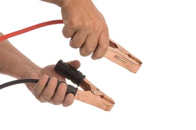

    I did notice that. The clamp had a secure lock on it, in my opinion. The clamp doesnt have those protruding bits to lock onto bolts nicely like some more expensive models have, as a result, it seemed fairly clamped onto the little metal bit.
    This is the style of the clamp:

    Some clamps may not conduct well from both sides of the jaws, so make sure you connect the side with the actual wire to the metal side of the jump terminal in the fuse box.

    Separate the jaws of your cable clamp with a piece of wood, then check for continuity from one side to the other, with a multi-meter in ohms or continuity mode.
