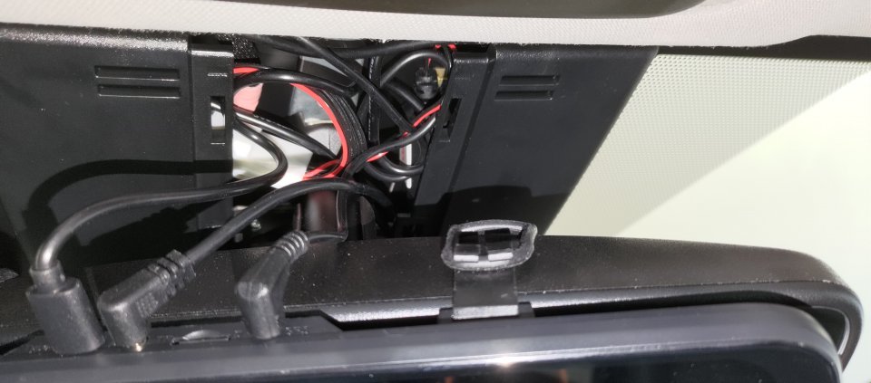

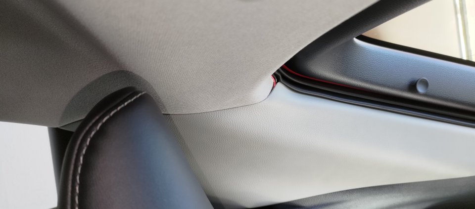

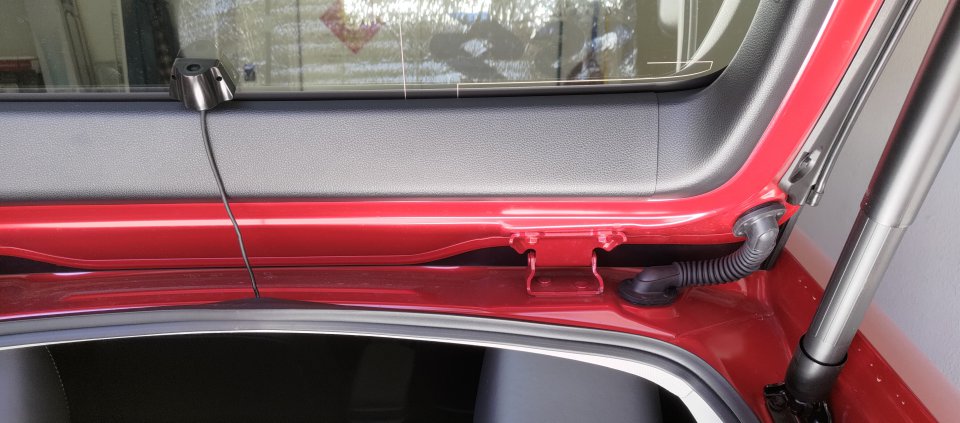

    I install a Wolfbox G850 as dash and digital rearview mirror.
    Is a cheaper option and cover the issue to the small rearview mirror and also double down as a dash cam.
    I was able to install it myself and add a usb type A power adapter so I don't have too use the type C or 12V ports.
    I was able to hide all wires and adapter behind the rearview mirror casing.
