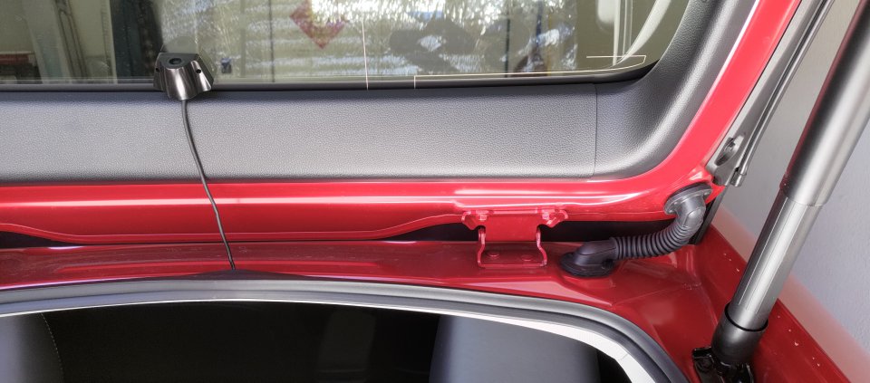

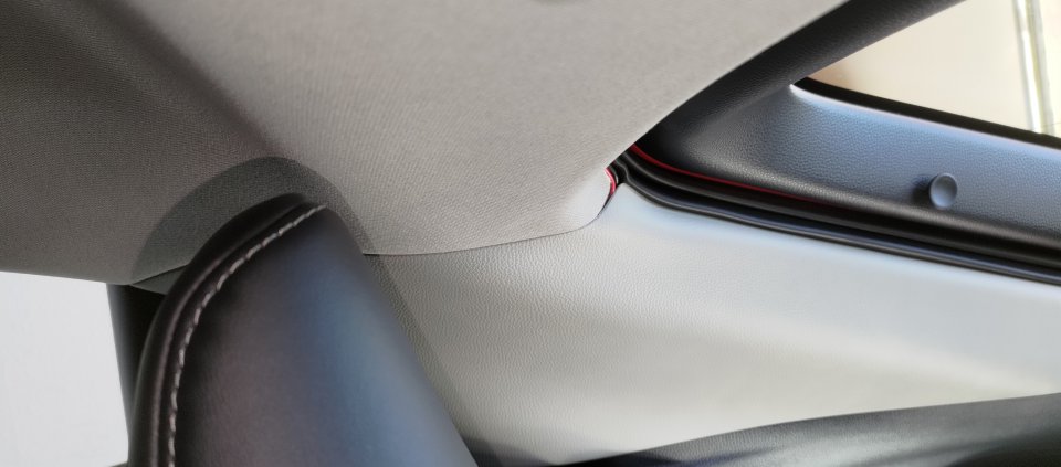

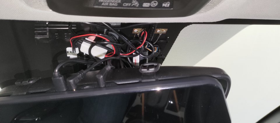

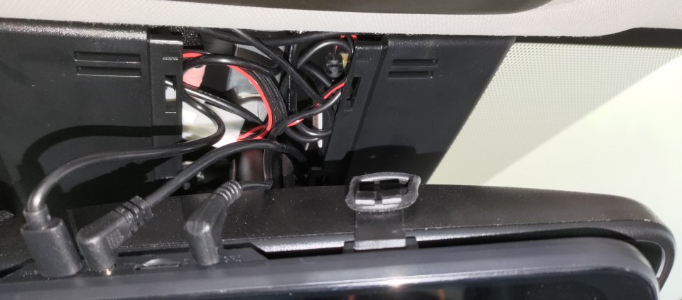

  19. deev
    deev Junior Member
    Mar 29, 2024
    47
    usa
    2024 Prius Prime
    XSE Premium
    @srwax great job! Would you show more pictures on how the wires are routed from the back to the front? I am a bit confused now. thanks.
  20. srwax
    srwax Junior Member
    Aug 7, 2023
    29
    31
    Las Vegas, NV
    2023 Prius
    Here are a few more pictures.
    You can pull the black robber out of the trunk frame completely because it's not glue.
    Once it's out, you can tuck the camera wire into the trunk frame and follow the ceiling frame gap to the center concel.
