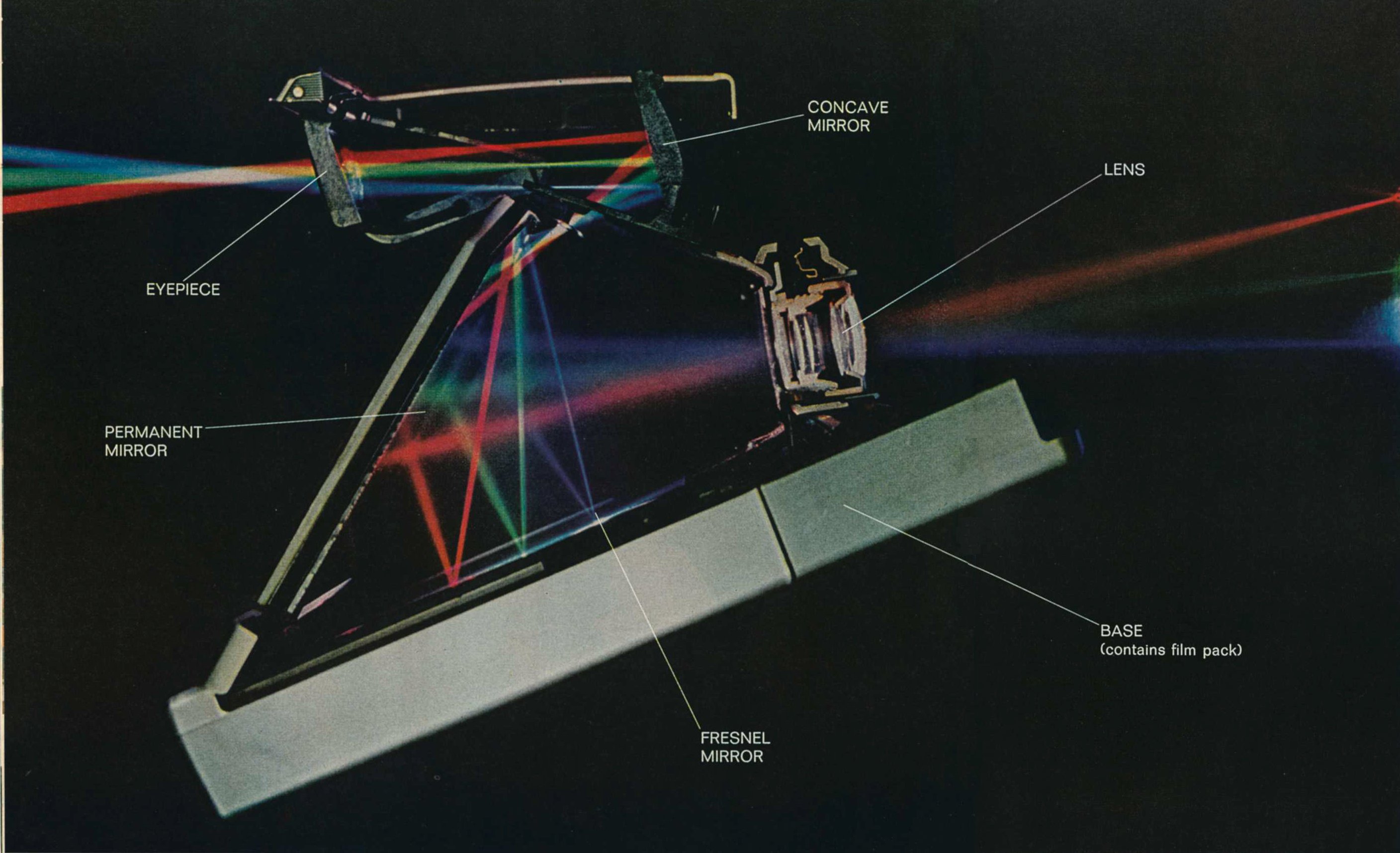

    What keeps dust out of the area which includes the actual display and the first mirror?
    This shows how old I am, but that diagram immediately reminded me of this wonder of optical engineering:
