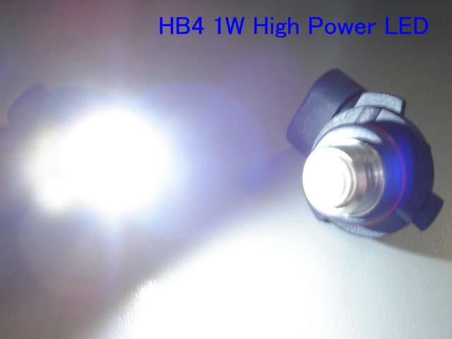

    I wouldn't know. I just did a search on eBay Motors. $100 is a bit pricey for me since the fogs are basically decoration.

    So I don't understand. When I was growing up Amber/Yellow was the color fog lights were supposed to be. When did this change to white? Also it really seems like these are driving lights not actually fog lights because in fog you don't want anything really bright due to the reflection of the light.
    Anyone change these out to Amber/something else and like the results in actual bad weather?

    It's probably just a poor English translation. My translation of that poor translation is that it's very bright (city lights do like up the city right?)
    <div class='quotetop'>QUOTE(Bert Fenenga @ Apr 7 2007, 10:18 AM) [snapback]419408[/snapback]</div>
    Yellow is the colour of foglights. While we still use the term "foglights", for whatever reason yellow doesn't cut it (no pun intended) and people wanted whiter lights (which don't work in the fog as well as yellow). I guess you could call them driving lights especially since we can't turn them on without the low beams on.
    You could just add a yellow tint/film to it if it helps but just note that the stock bulbs produce a lot of heat.

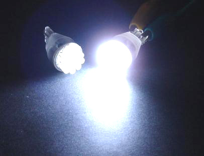

    Ok, finally got a chance to install and take pictures. The replaced LED is 2 Watts. The original bulb was 5 watts. Enjoy!
    [attachmentid=7533]
    [attachmentid=7534]
    [attachmentid=7535]

    WOW! That looks really bright! Did you take a pic of the fixture with the 42mm bulb in it? How did you rig that?
    I finally got the LEDs shipped from Hong Kong yesterday and installed them. I'm a little disappointed, they seem much dimmer and much bluer than white, sort of cool-white-flourescent-tube color.
    One of the 31mm festoon bulbs didn't work, so I left the cargo light alone since I don't use it much. The ones I really like are the flank firing ones in the lower front doors. Good ground light. I'll leave them all in for a while and hope I get used to the ghoul-white color.

    Festoon bulbs does not seem to be polarity reversable. Look in the back for a red dot. It is the positive side. Cargo light housing also has color coded label so it is easy to figure out. As for how I got the 42mm bulb in is pretty simple. I got it work with a simple paper clip. I'll post pictures tomorrow.

    One thing to note: While the wattage of the factory bulb is obvious - the draw from the LED replacements is not - unless you measured it. If it is marked "2W" that simply means that an LED capable of dissipating 2W. Doesn't mean that's what it draws. And even if it did, that doesn't take into account the overhead of the circuit.
    All that said, there's no way that the LED itself will draw 2W. That would be about 700mW, and would quickly overheat and eat itself for lunch. So.. the thing could coincidentally draw about 2W - but that's not 2W of light you're getting. If that makes sense...
    As for the blue - that's a sign of either a cheap LED, and/or an over-driven emitter. Either way, durability can be a concern.

    A few people have questioned what LED's to get. I did purchase some and currently have them installed. I bought them from the warden guy on eBay. Here's what I got and some thoughts on them:
    Courtesy door lights: #168 Flank LED (White).
    Front map light: #168 Wedge 6 LED (Xenon white) --Has 6 LED's
    Map lights: #168 Wide Angle 12 LED (Xenon White) -- Has 12 LED's
    Rear dome light: 31mm Festoon LED (Xenon White)
    Cargo Light: #3175 Festoon 12 (Xenon White) --Has 12 LED's.
    Also bought #168 Inverted LED (White) to test out as a front dome light.
    Here's some thoughts:
    The glow of these are the ghostly blue as suspected by others and shown in the photos. I'm not so sure that I'll keep all of them in. The warm glow from the OEM bulbs goes better with my beige interior than this color.
    The flank LED's don't fit in perfectly. In the lamp fixture, there are little metal tabs that held the cylindrical OEM bulb in. These need to be tweaked to hold the squarish LED board in otherwise, the LED is only loosely held. Not a big deal, but go easy with the needle-nose pliers when doing this so as to not crunch the LED.
    The Festoon cargo light has 12 LED's but guess what: Half of them face in opposite direction. This means that when you put the LED light in (After bending the metal arm to accept the longer light) 6 LED's face away from the cargo area and into the light housing. I spray painted in the interior of the housing (White) to get some return from these 6 backward facing LED's. As mentioned by others, the light switch is quirky in that the bulb rotates as the switch is used. I put a blob of generic silicon sealant/caulking on the end of the LED away from the switch to bind it to the terminal.
    The rear dome LED is also slightly longer than the OEM bulb but it doesn't take much effort to get it to pop in place.
    As mentioned, they all have a certain polarity so if they don't light up, swap them around.
    Be aware that these LED lights are not really that bright! <_< They are only slightly brighter than the OEM bulbs. Yes, when you look at them, they are brighter but that's not what counts. One measure of brightness is how well they light up what you need to see. Whether it's part of the interior, the whole interior or a map that you're trying to read. For comparison, I pulled out the illumination meter and produced some numbers:
