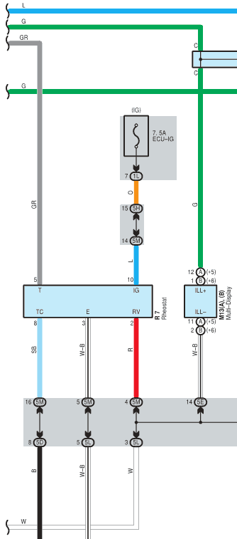

  7. ChapmanF
    28,371
    18,772
    Depends on who's doing the saying. While the thing is called a "rheostat" for historical reasons (same way people still talk about a blower motor "resistor" even though it's an electronic controller now), there's more to it than that. The dial you turn is a rheostat or potentiometer, sure enough, but it's a tiny one, and the rest of the unit, I'll bet, is an electronic follower circuit capable of handling the current from all the illumination lamps being dimmed. That's why it's not going to conform to simple expectations of how a rheostat looks to an ohmmeter.
    The IG terminal gets power when the car is IG ON, and the T terminal gets power when the taillights are on. E, of course, grounds it.
    The lights all get +12 volts from the tail relay when the taillights are on. The dimming happens on the low side of the lights, which do not return directly to ground. They return to that multi-junction (see the right side of that gray box above) and through the "rheostat"'s RV terminal and out its E terminal to ground. The "rheostat" is controlling the effective "resistance" or drop between RV and E, but electronically, following the setting of the tiny actual rheostat you turn.
    TC is an output to the combination meter, telling the meter you have selected the position where the dial clicks. (The meter, otherwise, appears to dim itself by watching the RV voltage too; that's the white wire to 5L-3.
    Have you noticed whether your "glitching" is just the brightness of the combination meter itself, or also the various other dimmed lights like the radio controls and the hazard switch backlight? That might give you an idea whether the problem is in the, hehe, "rheostat" itself, or in the TC circuit to the combination meter.
    Edit: never mind, it unglitched when you pressed up on the dial, seems conclusive enough.
    Toyota adamantly discourages trying to open or clean switches, lest you create a hazard. I've occasionally, and successfully, done it though.
