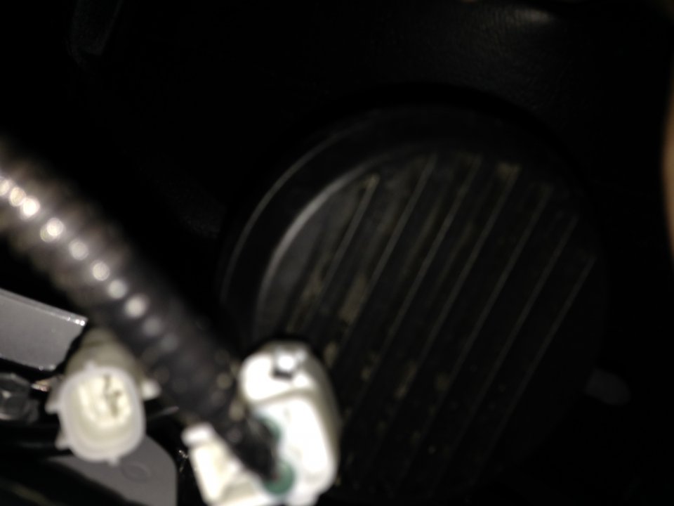

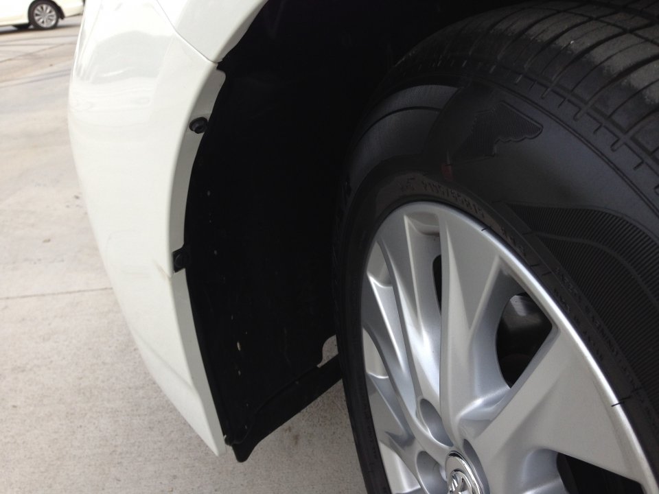

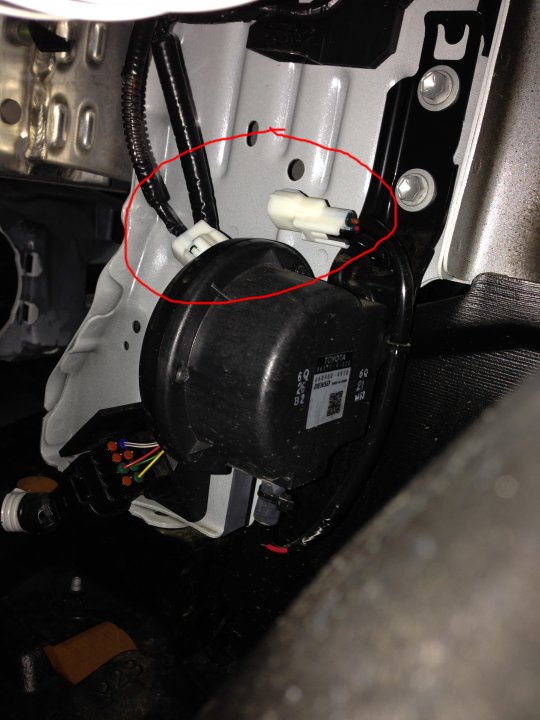

    So I found an easier way to disable the Vehicle Proximity Notification System than reaching down from the Driver Side of the engine bay. I unbolted the driver side fender lining and just reached in and unplugged it. Super easy just a couple of push pins and a small bolt. When you open the fender lining up you will see the back of the speaker and a white wire harness. Just unclip it and you're done. I circled the wire harness you need to disconnect in the picture. By the way in the picture I already disconnected the harness. The whole process took about 5 mins. Hope this helps you guys out. :)
    This is the view when you open up the fender lining. Unplug the white wire harness I circled in this pic. (In this picture I already unplugged the wire harness)
    Front view of the speaker. Sorry I couldn't focus on my camera phone. It was to dark. :(
