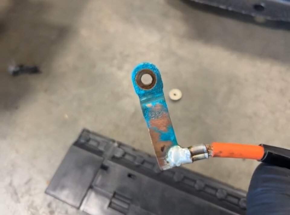

    Must of missed this thread when I was dealing with my own P3009 issues back in November/January. Very different weather conditions (Eastern WA is a lot more dry than seattle) but iirc a similar theory of mine is that the times it happened was also more humid. Both codes happened when I was in a drive through late in the evening, and when the second one happened i caved due to being unable to replicate it and went and got the car looked at. No 3rd party mechanic around here would touch it and toyota never responded to my calls so I took it to a Honda dealer that had a Toyota master tech that worked there.
    They got the battery out and found a good chunk of corrosion on the terminals. Was quoted... $600+labor? For a new wiring harness, or they said they could clean the terminals and call it a day, which is what I chose. $800 total to get the battery out, harness cleaned/sealed, and reinstalled. Haven't had any issues the last 6 months.

    That is some ugly corrosion! My reman battery pack was only a year or two in from install when I got my first P3009. I was thinking maybe some corrosion - but nothing like that! I never looked. It showed up briefly once a year and then left me alone. So I did the same.
