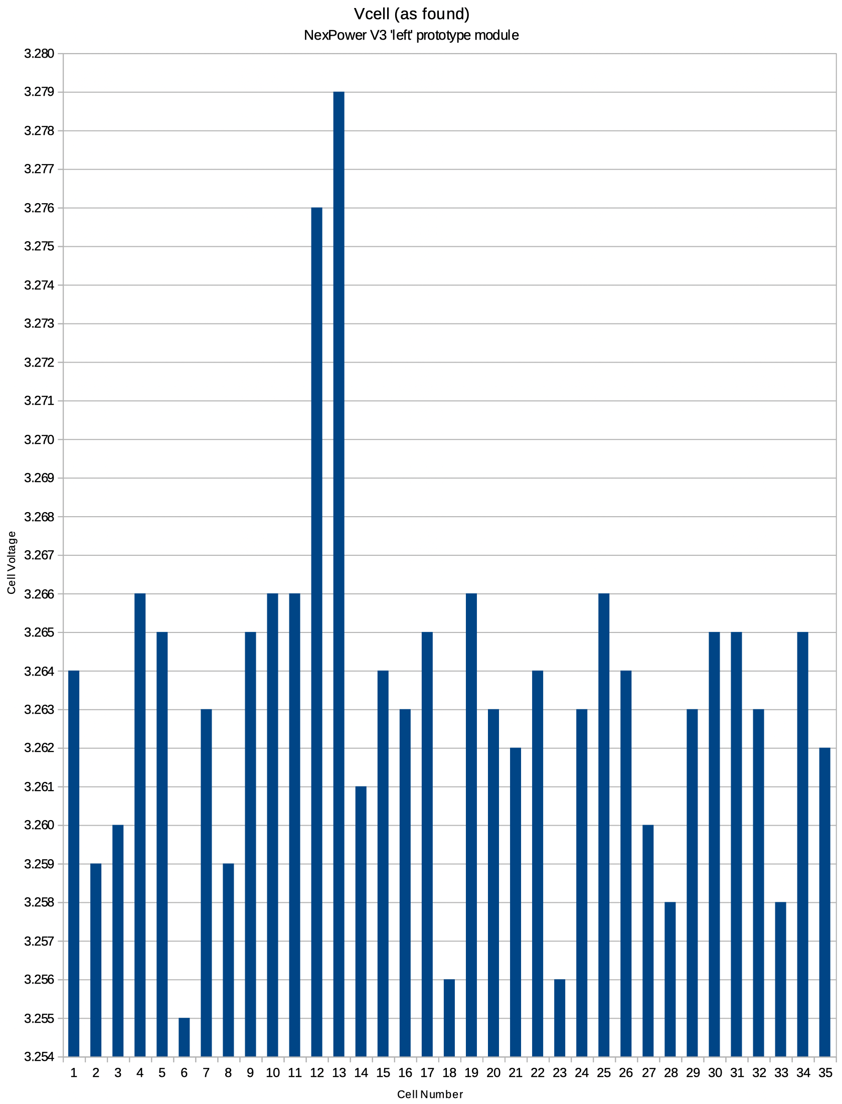

    Here are the as-found voltages on the 'left' module:
    There's a 144 mAh delta between the most-full (+15.7 mV) and most-empty (-7.3 mV) cells!

    No actual pictures of this said v3 pack either, just charts of what could be made up information like what stencil_box is claiming he bought his pack but has no order number. LMAO wow
