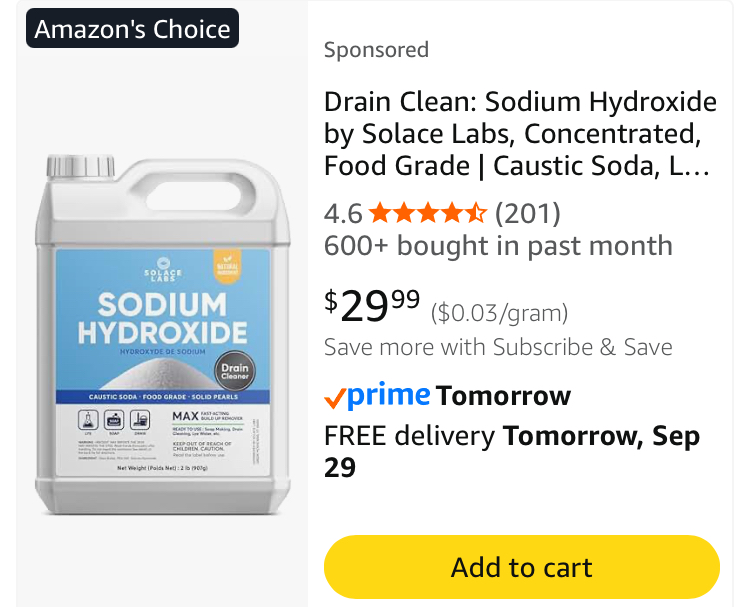

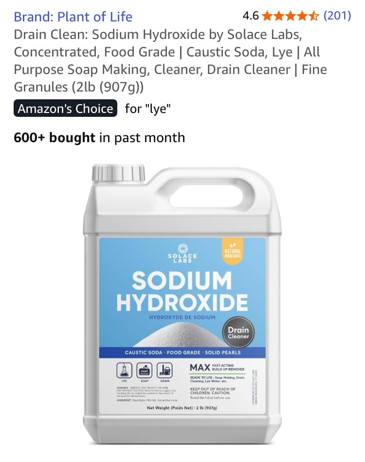

    Drain cleaner is a witches brew, mostly lye crystals, but various other ingredients, including apparent fine shards of metal (aluminum?). I would stick to lye, if you can get it.
    Lye used to be a readily available grocery/hardware store item, but has been off the shelves of late, apparently since it’s used in methamphetamine making.
    Amazon.ca sells straight lye, it’s a common soap making ingredient, but on Amazon.com (US site) it doesn’t seem to be available. I would think there’s ways though, maybe contact a hobby soap making supply place?
    Google:
    are lye sales restricted in usa
    attached screenshots from Amazon.ca:
    #73 Mendel Leisk, Sep 28, 2025
