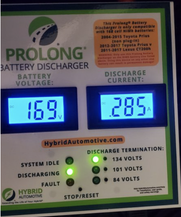

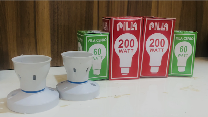

    Putting in mind the above prolong automated discharger voltages and their manual bulb discharger table link you shared.
    My interpretation for Prius 04-15 Discharging circle for 220v AC incandescent bulb would be:
    First Discharge: 240vdc+ ~ 134vdc (using 400w bulb or less. e.g 60wx6)
    Second discharge: 134vdc ~ 101v (using 150w bulb or less. e.g 60wx2)
    Third discharge: 101vdc ~ 84vdc (using 50w bulb or less. e.g 40w)
    Kindly confirm if my analysis is ok.
    #75 A.J, Jul 19, 2025

    Somewhat confused with the data displayed on your discharger. At 169V and 0.285A, the effective resistance is 593 ohms. Assume you use 360W light bulbs, the effective resistance at 240V should be 240^2/360 = 160 ohms. So the resistance goes up significantly with lower voltage. I thought the resistance goes down as voltage drops.

    That ain't my discharger, only used the image as illustration for my Bulb discharger. Charger owner is at Prolong Discharger problem | PriusChat
    Below is my upcoming setup
