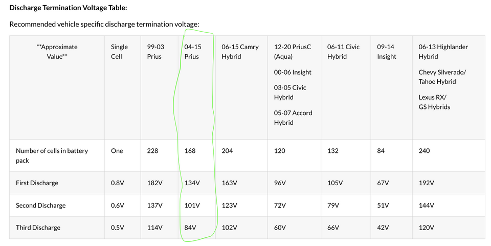

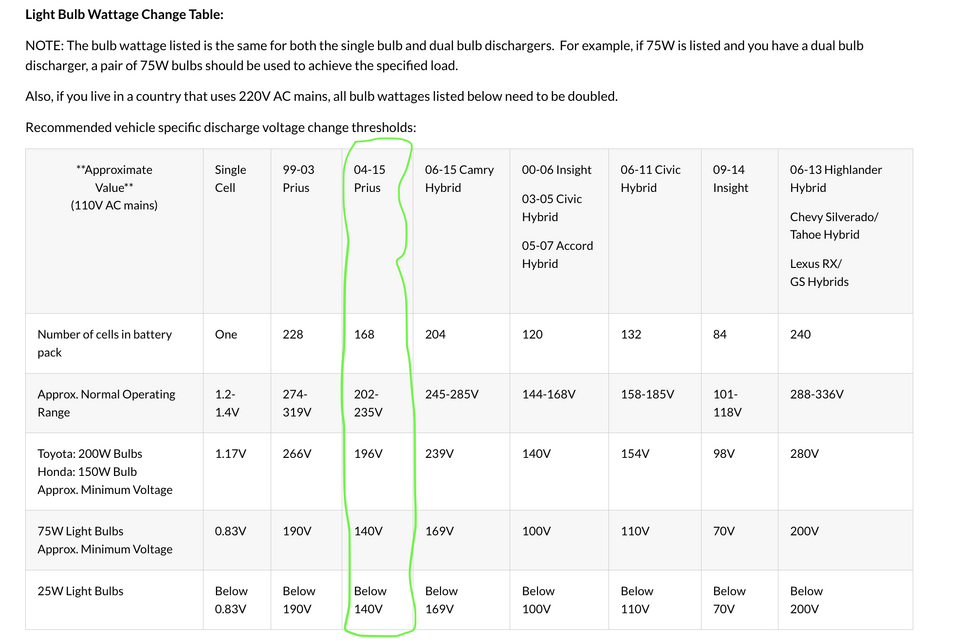

    Saw this video of a guy who used the Automated Prolong Charger and Discharger
    1st: Charge-Discharge 240+-~ to 134vdc.
    2nd: Charge-Discharge 240+~ to 101vdc
    3rd: Charge-Discharge 240+~ to 84vdc
    Then Charge
    UPDATE:
    My latest bulb arrangement for 220v bulbs:
    First Discharge:
    240+-~ to 196v: 400w or less bulb
    196v to 134v: 150w or less bulb
    Second Discharge:
    134v to 101v: 50w or less bulb
    Third Discharge:
    134v to 84v: 50w or less bulb
    But i use 60w in replacement for the 50w because i can't get a 50w bulb around.
    I have now attached the Prolong bulb charge voltage and wattage guide too.

    @Abarnabe Care to elaborate what's not right in @A.J's statement?

    Prolong has all the instructions on their website. Just follow the instructions as Brian said, what is worng in your first and second statements are wattage and voltages, below certain voltages you should lower the bulb wattages to reduce the risk of cell damage and pole inversion
