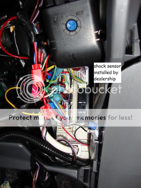

    I did put my inspection camera to good use today. I did find connectors on the backside of the Main Body ECU. I have no idea of how to get to them unless the white bracket can be opened. :confused: I didn't have time to try figuring it out today, so I don't know if it would be easy or hard. If anyone has any ideas, please share. Otherwise I will try to look at it again this weekend.

    RodJo,
    Wow! I'm afraid inserting a pair of wires through the ceiling lining could be the easiest way of tapping power from the dome light. It may be irrelevant but I really want to figure out that light blue wire on 2C connector #24 pin because the dealership where I bought the car tapped it with the alarm shock sensor. Sometimes dome lights are used as alarm trigger, right?

    According to the diagram, that sky blue wire connects with the horn switch on the steering wheel. So I assume the alarm is using it to sound the horn. I did look at the Toyota alarm diagram, and I seem to remember that it does tie into the doom light circuit, but just on the power side I think. I hadn't thought about it before, but I will try to find it and look at it again and see where it taps that line since it runs with the blue wire for a while.
    At the end of the day, the overhead map light assembly may indeed be the easiest, and I need to open it up for something else anyway. But I'm a little pissed that they seemed to have buried the connectors, and now I'm on a mission (fool's errand) to find the magic wire under the dash. :mad:
    EDIT: I should add that the diagrams show connectors 2A, 2B, 2C, 2D, and 2E/F as being part of the same block, so it makes sense that they would be together behind the white bracket.

    Unfortunately, the alarm connects to the dome fuse, so that's too far removed to be helpful.
    It's really called the Instrument Panel Junction Block. According to the Repair Manual, the 2A Connector should be on the lower back of the block (see attached). A common diagnostic step is to disconnect the junction block from the ECU and/or disconnect the back connectors. I have not actually found the disassembly instructions yet, but I'm thinking that if it is a step in checking a faulty connection, then it should have been made simple to remove. I'm hoping that I remove a screw and it just snap apart. It should be fairly nice tomorrow, so I will see if I can figure it out.

    I kinda give up looking for the dome light wires under the dash. Following is what I did to tap power from the rear dome light:
    Use a flathead screwdriver to remove the cover
    Use the screwdriver to push the plastic tags all the way toward the center and pull down the frame.
    You will see something like this except the golden color wires with the black loom. I was kinda modifying my earlier design to "door only" application. IMPORTANT: You also need one constant (+), in this case, just tap the (+) using a ring terminal directly from the dome light.
    Tap into the bottom (-) wire for mirror LEDs as shown in picture below

    RodJo has been trying to locate the dome light 2A connector for quite some time but still no discovery. It could be buried deep down behind the ECU and up inside the A-pillar. I don't really want to snake anything on the ceiling along with bunch of curtain air bags on the side neither. So, help finding the correct dome light wiring is welcome!

    I can confirm that the 2A connector is on the botton rear of the junction block. If you just put your hand up from under the junction block, you can feel it. Our wire is near the bottom (pin 1 is up). There is not much exposed wire and a boot is partially in the way. I assumed the connector is latched into place like the front connectors and I could reach what felt like the latch. My fingers could not get into the right position to remove the connector, but I did not try lying on my back (might not ever get out :D).
    In theory, we could also remove some plastic parts to get better access to the connector -- especially the white bracket. But the wiring goes through channels in the bracket or are anchored to the bracket. It turns out that either my fingers are too fat or there is a better technique to disconnect the channel, so I did not have much success. I am not yet willing to break something. Maybe we will find some help from someone outside this thread.
    Alternatively, if you notice from the attached photos, the wires from the 2A connector come up through the top channel and then come forward over the parking brake area. You can see that the mass of wires are all exposed at the top of the bracket, standing vertically. One of the blue wires should be the Courtesy Ground. I do not know how many blue wires are there, but the 2A connector itself has 5 blue wires. So we could just tap each blue wire (ignoring any small wires) until finding the right one.
    Once my lights come in, I will try to use more effort, including trying to fit my head underneath the connector. Once it's in better view I should be able to tap it (by either removing it or not).
