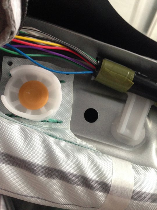

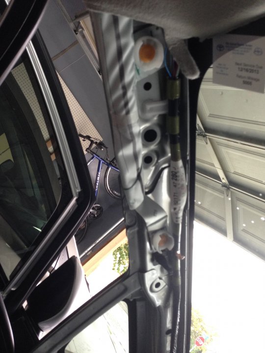

    Just wanted to thank everyone for the install and tips. Just completed the install a week ago on my 2013 Prius 3. I took some pictures of the blue wire in the A-pillar. After reading through ~50 pages, I couldnt find a good picture, so I decided to take one. The install was not too bad, just took a while. Everything works perfectly :)

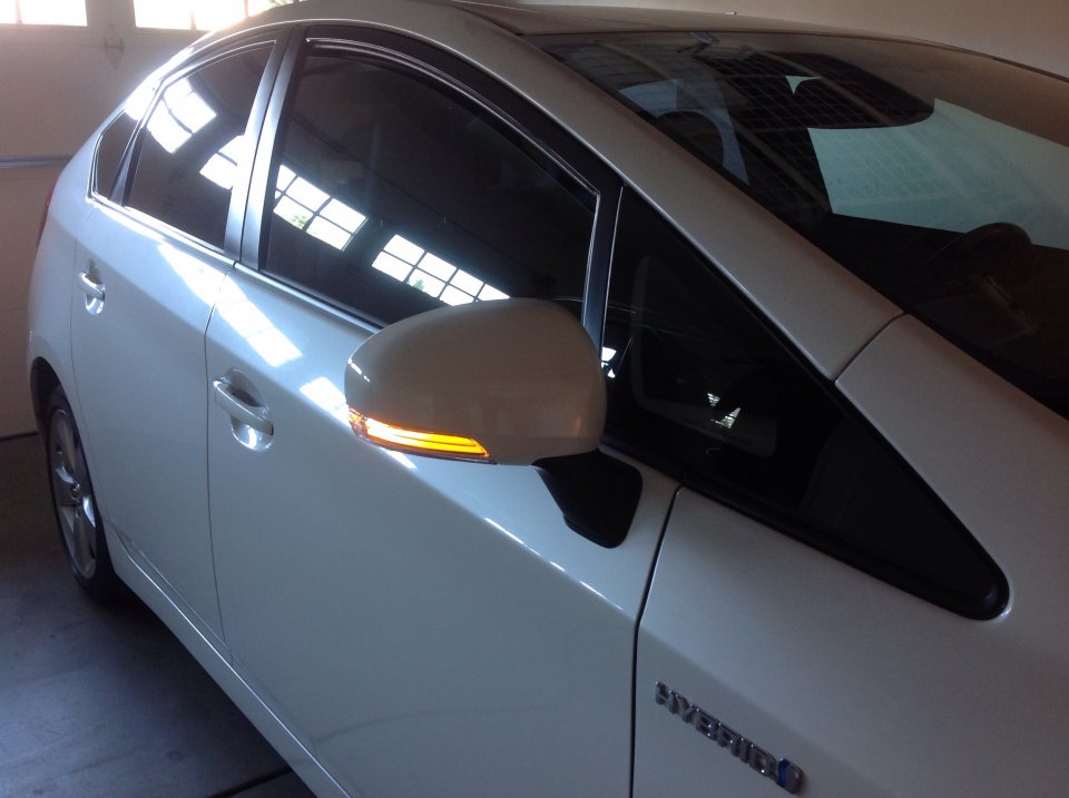

    I had my covers installed this weekend by Sean (sfv1901). He did an amazing job. I highly recommend him to anyone needing install help in So Cal. I got the covers/lights from Mita Accessories on eBay. They were shipped very quickly and the color match is perfect (Blizzard Pearl). This is definitely one of my favorite mods! image.jpg
