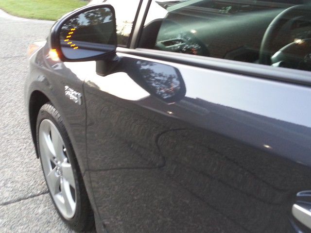

    Hi there. I have everything I need to start this mod, including the LED turn signals for behind the mirror glass. As a wiring noob, this thread has been immensely helpful. So...thanks to all who have contributed. I have my wiring locations all mapped out except for the LED turn signal arrows pictured above. Can you shed any light on where you connected this, or what kind of source the two wires on each arrow should be connected to? Thanks in advance.
  19. -1-
    -1- Don
    Jan 16, 2013
    1,247
    434
    Chester, Virginia
    :confused:I wish I had a good answer. I did the install over a year ago, and I can't honestly remember. I believe they were wired to the LED mirror lights, but not sure. There are several good YouTube videos that will help with removing the back off the mirrors so you can install the arrow LED lights. They might answer the wiring of the arrow LEDs. Good luck.

    Assuming that the 2 wires on the glass LEDs are red & black, u can tap the same colored wires from the 3in1 signals during it install.
