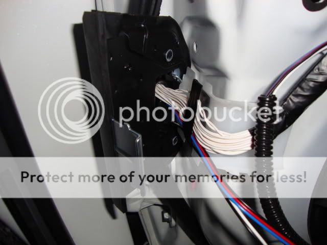

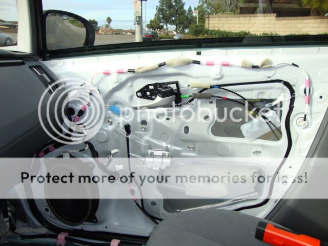

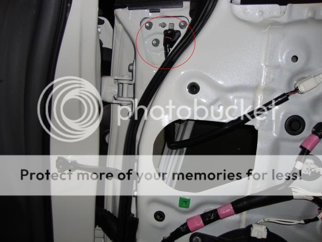

    There are no suitable wires to use inside the door interior panel, plus there's also no constant 12V power. You wouldn't want your puddle lights to only turn on when you either adjust your mirror or use your window switches... ;)

    I'm referring to puddle lights on the lower part of my 2010 interior door panel. I think they operate with the other interior lighting. Just less wires to fish through to the dash if you can use them for you side mirror puddle light.

    Sorry, forgot about that light there inside the door. I think the reasoning why you wouldn't tap it there, is it would only operate when the door is ajar. Thus defeating the purpose of having it illuminated before you step into your vehicle.

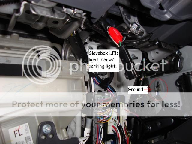

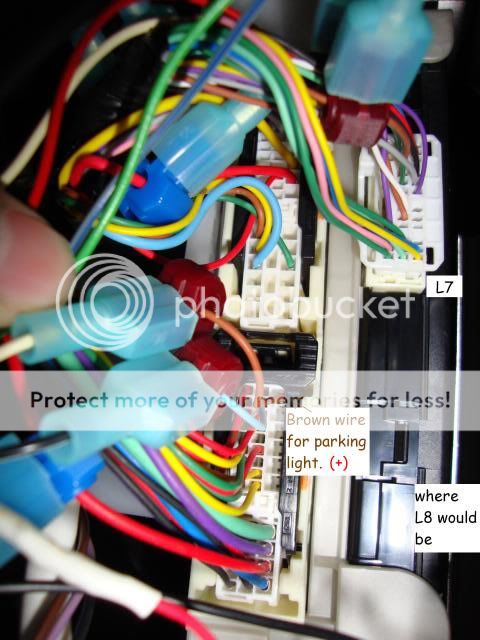

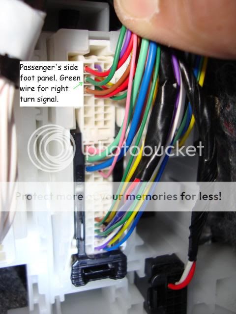

    These are where u can tap ur wires for all gen3 Prius
    This is at the foot well junction
    Turn signal & Parking light
    Constant 12v+
    iPhone ?

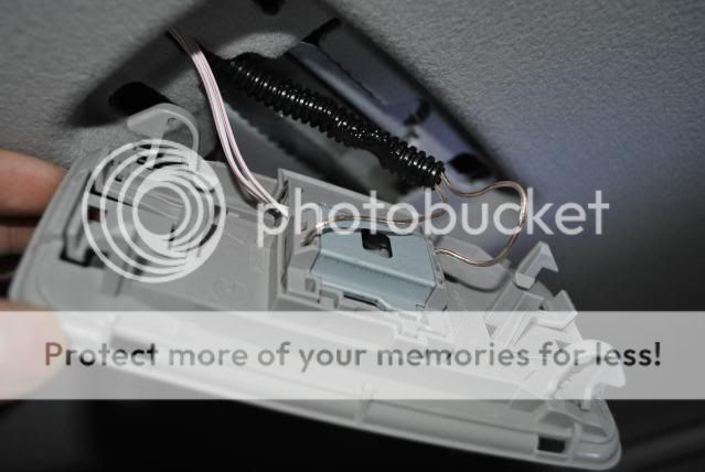

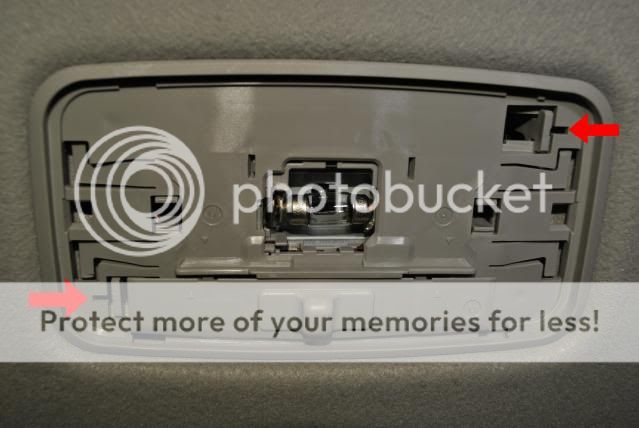

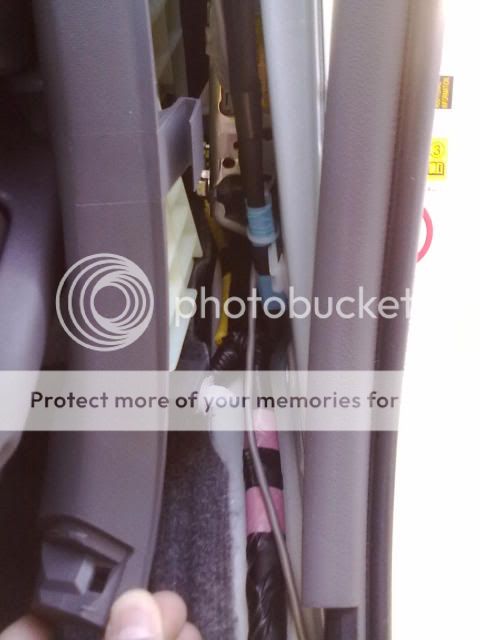

    You can also connect to the interior light wires along side the A-pillar on the driver's side. I connected to the "ceiling light" because I was lazy and wires are cheap!

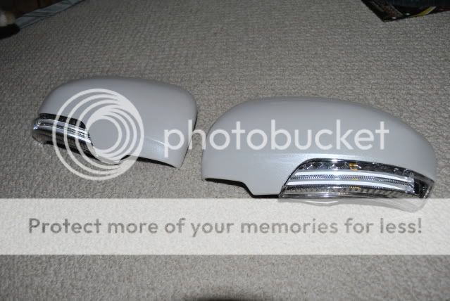

    So, just quick a update to this thread. There is a version 2 of the next gen sequential lights. The original sequentials in white are similar in color to the G's OEM HIDs (like a 4500K). The newer versions of the sequentials will have more of bluish tint, similar to what is found in more modern cars (like a 6000K). Found this out the hard way as I was like the more subdued color of the more yellowish HIDs (anyone for a swap?), but both versions are bright AF, and very nice. Haven't had the opportunity to source the difference in color yet.

    I’ve installed the LAXparts folding mirrors before. They are not 100% PNP with the Prius. The electrical connector doesn’t match the Prius & uses aftermarket motors & glass. Do they work....yes. Would I recommend them...no.
    I can confirm that u can use a 3in1 signal in them.
