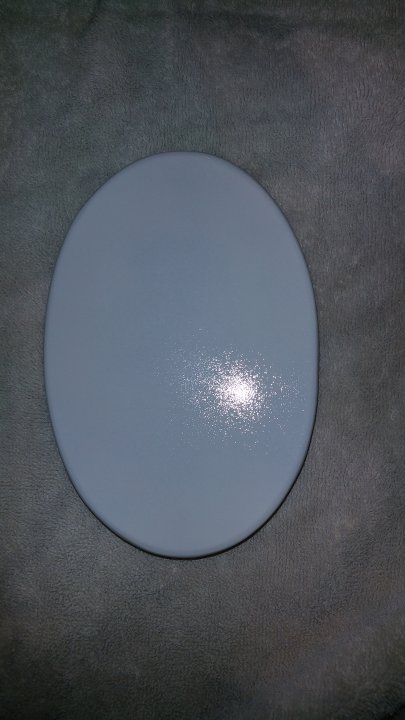

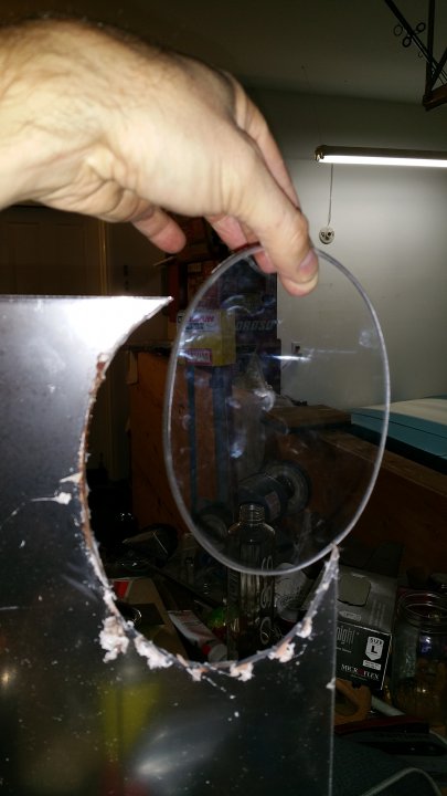

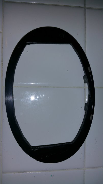

    Traced out the center section and cut out from 1/4 inch (.220) lexan from HD.

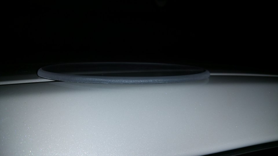

    1st photo - profile view of rounded edges of the lexan emblem

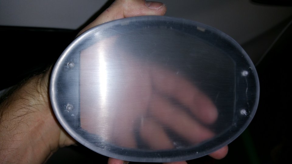

    2nd - drilled the lexan 9/10 of the way through with pilot holes for #6 SS Sheet metal screws w washers. Here is what it looks like from the back side.
    3rd- scuff sanded the entire surface with 2000 sand paper to help the primer bond.
    4th - 2 coates of plain flat white plastic primer

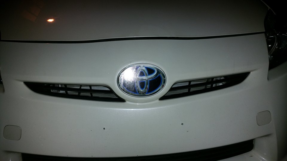

    5th - Installed on the grill.

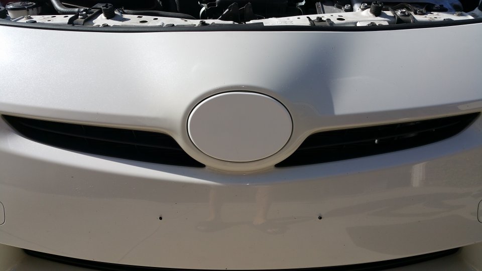

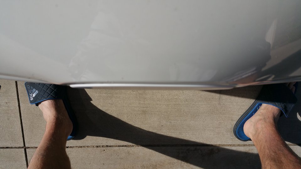

    6th - top view showing rounded corners and distance it sticks out from flush.
    Tested on road trip today... 100% success! I was worried the the SS screws might effect the radar. Not at all. Radar performed the same as with no emblem at all. Cars were sensed going around curves and distance was jot effected.
    I dont have the proper emblem. I Purchased the car with a standard emblem and radar was constantly malfunctioning until I removed the emblem completely.
    Next? Planning on either painting on a simulated emblem? Or buying/ having made a sticker that copies the emblem. Not sure yet. I am currently enjoying the "stealth" look. Any thoughts, comments, questions welcomed.

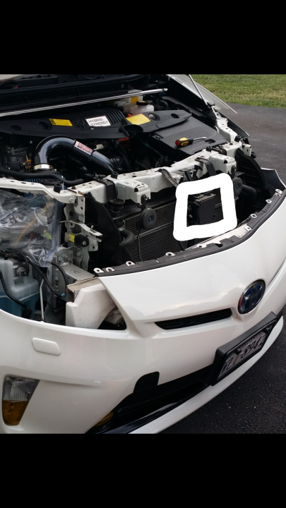

    The radar sensor sits about 4-6 inches behind the emblem. The emblem is just a cover that is made of "invisible" material as @kenmce quoted so well above.

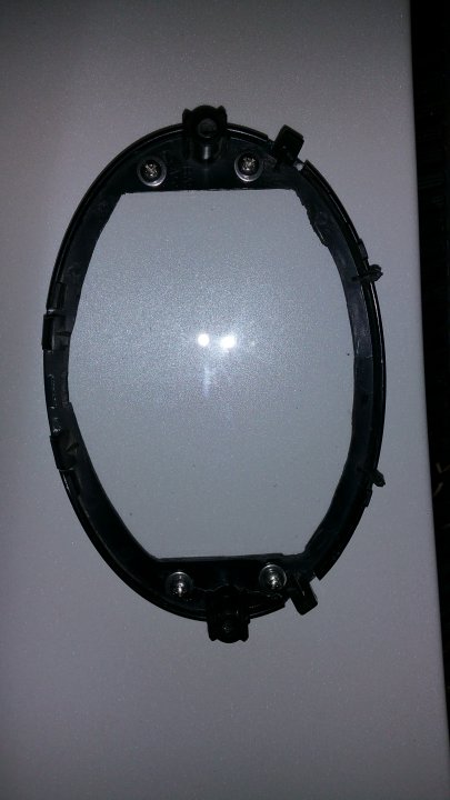

  10. Ron Jorgensen
    Ron Jorgensen New Member
    Nov 13, 2014
    That is the radar sensor circled in the picture. A small square box with mounting tabs on the sides.
    I can still make more lexan disks for the emblem. The sheet of lexan was pretty big so I material remaining. I only had one emblem backing piece (the black part in the pictures) so I could not reproduce the entire thing. Unless I was to go to Toyota and purchase that part.

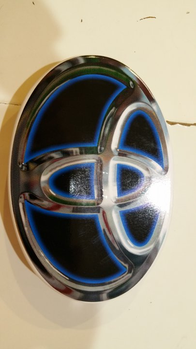

  12. Ron Jorgensen
    Nov 13, 2014

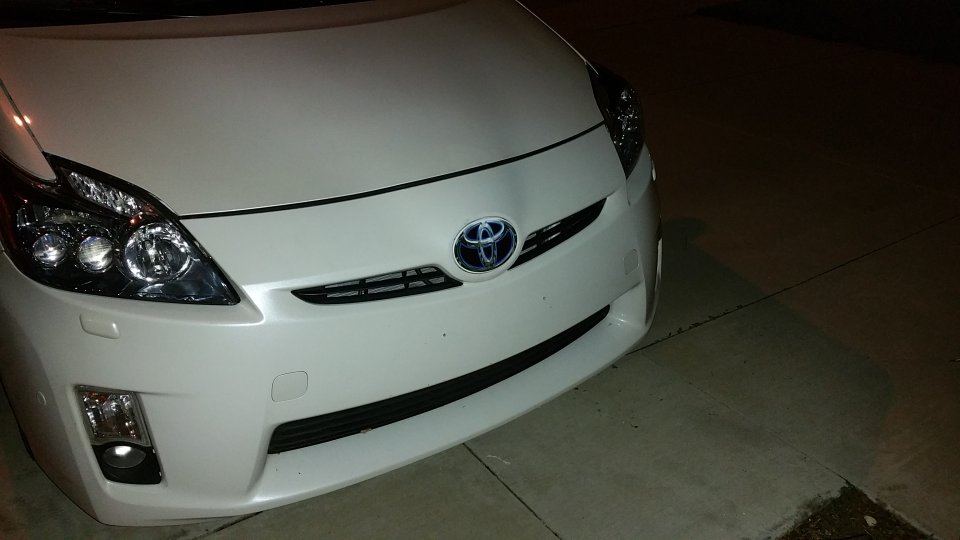

    Update. I received the stickers that I had custom made to look like the factory emblem. I was able to get them with 3D effect and simulated reflection. Here are the pics. I will see what it looks like in the sunshine. Not bad for a sticker!
    Accordlayingkit likes this.

    looks real nice Ron!
