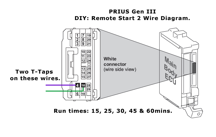

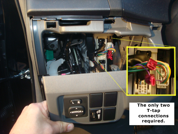

    No extra fob is needed. The box I use holds the remote start module, nice and neat. I removed all the wires that attach to the module and I just soldered the ODBII connector leads right on to the board. This makes it very easy to install, except for the two additional wires in the original photos. I would like to eliminate the two wires but I don't see how.

    I'm starting to get more interest, so I'll post better photos or drawings this evening on how to find the two wires that are needed before you plug in the ODBII.

    Here's a zoomed out view of the same two connection from above that you need to make with wires prior to plugging in the OBDII. Here you can see the exact green and purple wire we are looking for.
