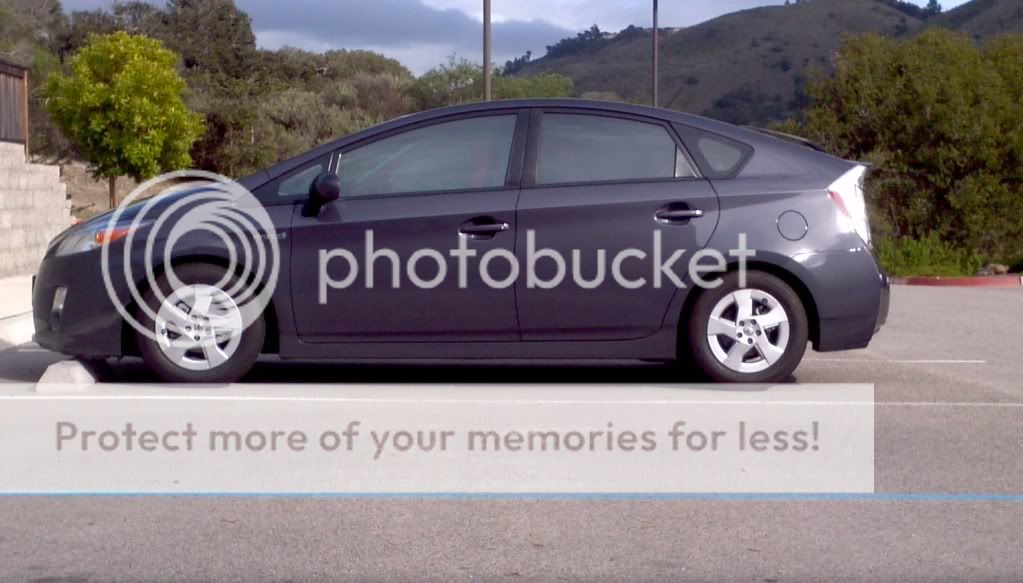

    Here's a picture of my ride with Tanabe NF-210 springs installed. I love the look, even with the stock 15" tires. It doesn't look like a Prius. The ride is great. I had it in the dealership for a 4-wheel alignment, only discrepancy was the front toe-in which usually doesn't change when shorter springs are installed (camber usually suffers, not in this case). The young tech test drove the car & thought it rode "stiff" - LOL.

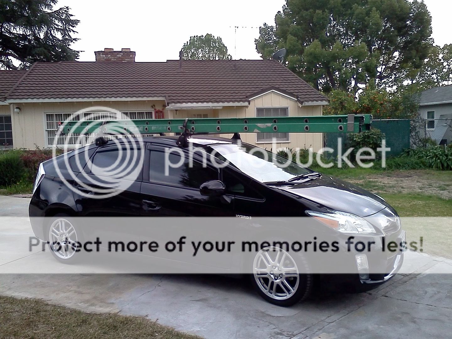

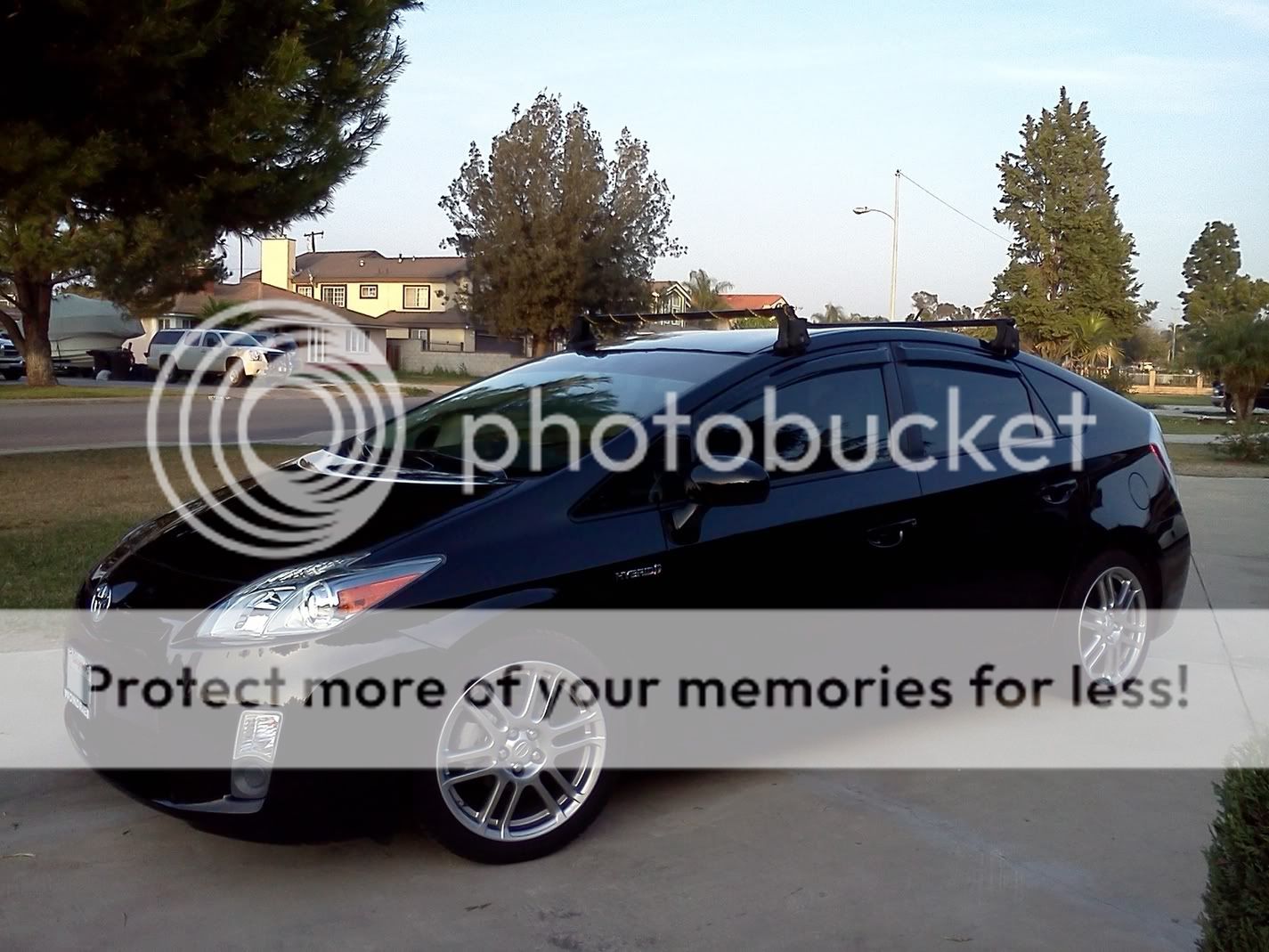

    thanks for the diy guide. i would of never dared take the wipers off.
    got the tein h and would have liked it better if it was lower but i guess its good enough since its my work truck... i mean car.
    before
    after
