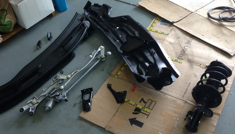

    Great DIY! Here's a few things to add along with a photo.
    I few things I learned from my install.
    1. Wiper nut cover on driver's side is plastic. I was concerned with scratching it. You should be able to twist or push it to the side enough to get to the edge and then pry it off.
    2. My 3/8 drive impact gun made job much easier.
    3. Must have a 1/2" breaker bar or 1/2 racket with cheater to loosen and tighten front lower strut bolts.
    Here are items removed to gain access to front strut tower;
    Parts removed to install Plus springs by sfcyclist2012, on Flickr
