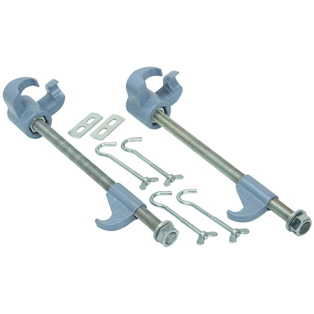

    The OEM springs do take a bit to compress. These are my trusty spring compressors who've helped me with over a dozen spring swaps :)
    When you are compressing the OEM springs, you want to slide first clamp to the top as far up as it will go around the coil. The second clamp should go directly to the opposite side of the spring from the first one.
    You can also pick these up from an AutoZone as a free rental if you don't want to purchase them.

    Those look better to get across as much of the spring as possible, almost went with a similar if not same one, saw on Amazon for $59. Instead I cheaped and got these from Harbor Freight for $13.99.. ImageUploadedByTapatalk 21370623912.520553.jpg
    I think the clamps are too fat for our springs with so few coils. Get what we pay for surely. I may try another set since I want to succeed and KNOW it can be done. Next time for real will be a snap! Hope soon so I don't have to get 2 alignments! Thanks for the help

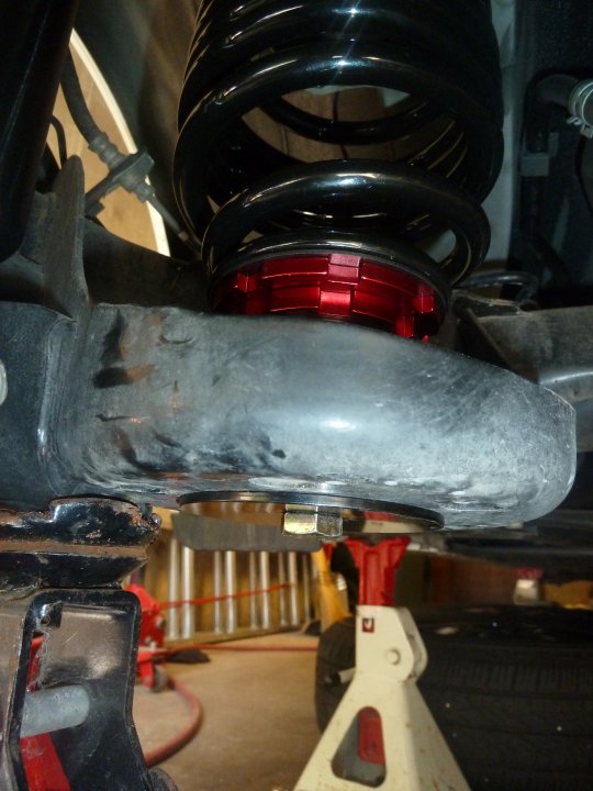

    1) Fronts install the same. I set the height to 1.5" (bottom of spring perch ring to top of height adjustment ring). This gave me ~1.6" drop. You can adjust up/down from there depending on the drop you want.​
    2) The rears you have to replace the shock. There's a panel in the rear hatch that you pop out to unbolt the shock. You will need to reuse the rubber mounts from the stock shock. There are two rubber pieces that you reuse, one is inside the trunk under the nut. The other is on the the other side on top of the dust cover.​

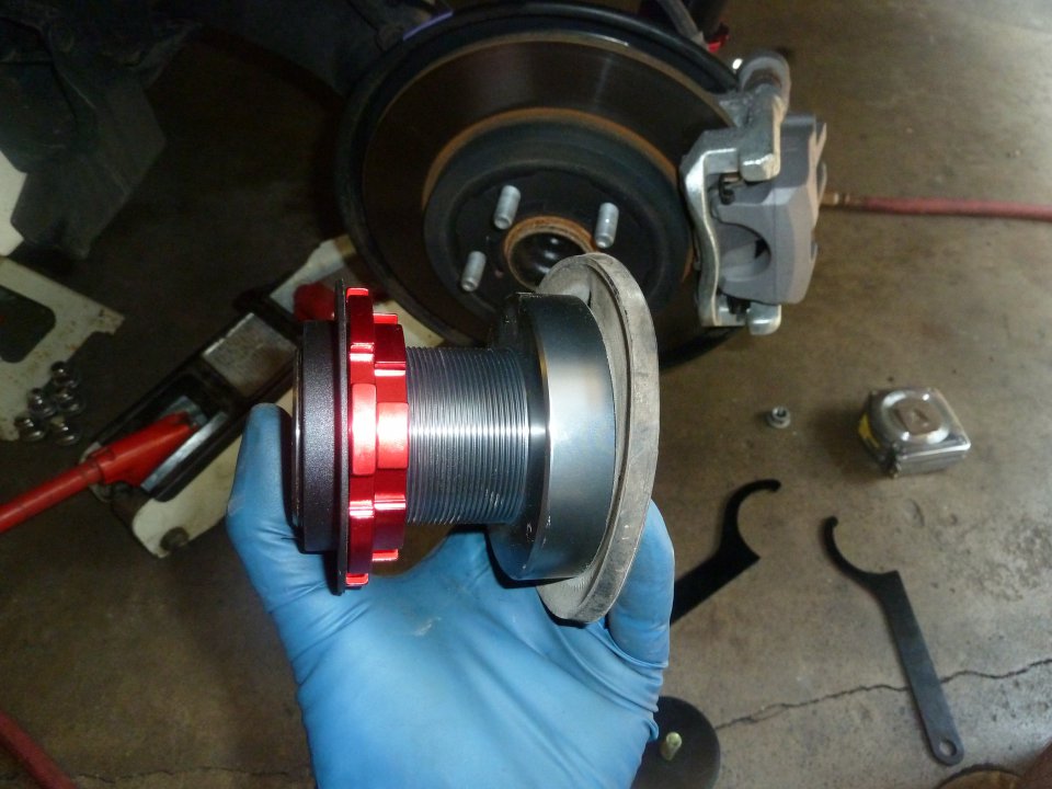

    3) The instructions, aren't very clear for the spring mount/adjuster. From what I could tell, you will reuse the rubber pieces. One for the top and the other goes underneath the mount/adjuster. There's a big washer that bolts and holds the mount/adjuster to the bottom. I set the distance between the bottom perch ring and the base to 1 1/4" and this gave me ~1.5" drop in the rear. Here's some pictures that will hopefully explain it better:​

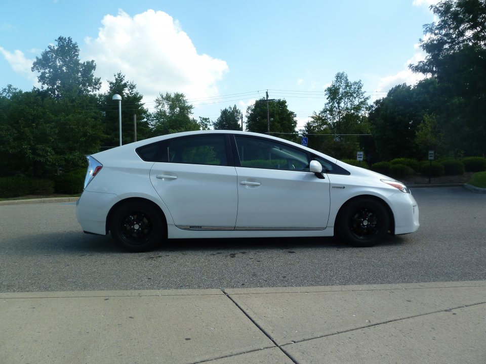

    The finished product:

    So far I like the ride. I'm still playing with the dampening. Right now I'm set on 25 and it's giving a pretty nice street ride. I dialed it down to 5 for some up/down hill twisties & that was fun!

    Are you running stock rims and tires?? Your ride looks really good. I'm thinking of doing the Megan's but don't want it to look bad because I can't afford to do rims and tires for a while.

    Yes, I'm running stock rims and tires for now. I upgrade the wheels with the $4 or so electrical center caps. It looks pretty good with the stock rims. If I wasn't saving and trying to decide on new rims, some spacers would finish off the look.
