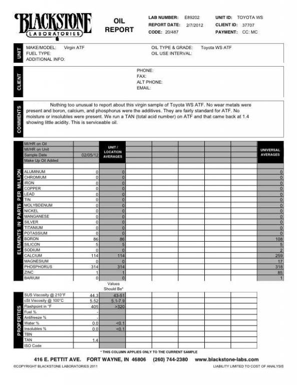

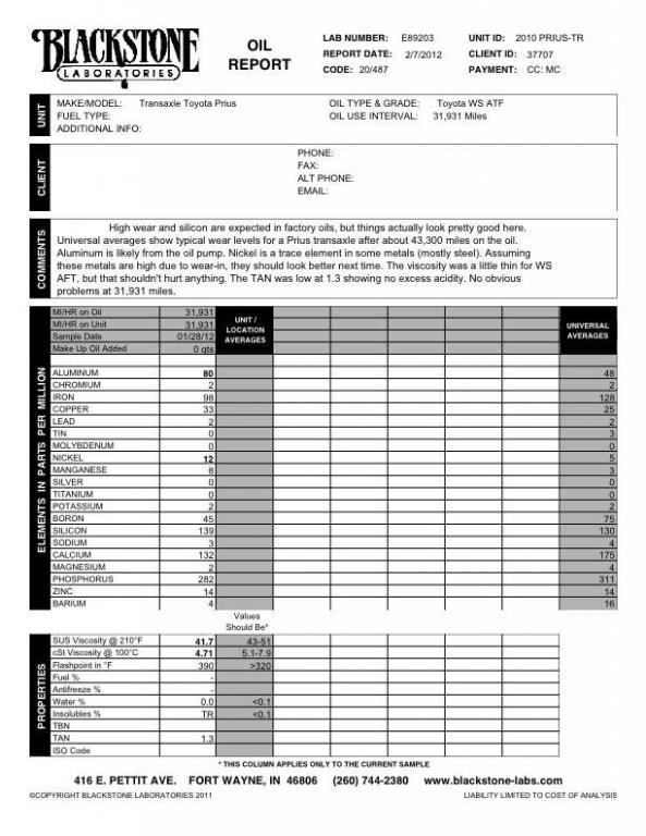

    And, here's my transmission UOA after 32K:
    And here's the virgin fluid report:
    2 people like this.
